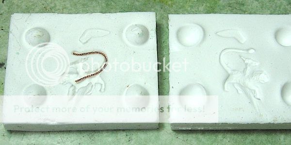

I'm not sure what you mean as matrix for the Chimera... once sculpted I just apply liquid wax and put the masters directly in the mold.
You can see the copper wire plait support in the mold ;-)
And in the other photos you can see Dionysos arm is inside the valve, you can tell also by the resin flash layer on the figures casted, where the relative cut allow to release the arm from the mold.
I make a little cut once the mold is hardened, or put a thin layer between the arm and the body (or to the inner surface of the mold), so I just have to spread a bit the hole bending the mold, and insert few drops to fill the hole before rest of the mold cavity.
Sometimes instead I give the mold a shape with mold lines which follow the sottosquadra, it depends from how deep and which position is the protrusion, and also from the softness of the mold… if I choose this or the other way.
Sometimes if the casting is too difficult I also make figures with separate parts to be assembled.

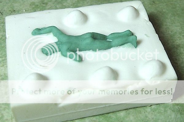

What else… a good trick for moldmaking, despite it waste a bit of silicon...
when i use molding silicon (non liquid bi-component) and the back of the figure have many details, sometimes I put the master on a first thin temporary valve which will be deleted, once made the second valve I remove that first one, and do it all over again to be sure the silicon fills all the details and cavities. :winky:

Phersu wrote:once sculpted I just apply liquid wax and put the masters directly in the mold.
Where do you apply wax? And why? Since the sculpting will not stick to the silicone. I do use cooking oil as parting agent but only to keep the two rubber valves separate from each other when casting the second valve.
Phersu wrote:when i use molding silicon (non liquid bi-component) and the back of the figure have many details, sometimes I put the master on a first thin temporary valve which will be deleted
Why use non liquid bi-component silicon in the first place?
How do you apply that? With a brush? Or pressing it?
What I do not get: you press your figure in the first valve when it is a wet, silicon surface.
After 3 days that is dry.
How do you add the other valve: I would say: pour it on top of that.
But that is not possible with silicone kit.
Do you press it on top of the first valve?
But then there will be air bubbles under it.
Or do you apply different thin layers by brush, like when making a latex casting?

Paste silicon is very useful in some situations, and can be a practical alternative to the first bottom base in plasticine... which I find very annoying and difficult to remove :sweatdrop:
A provisory bottom base in silicon instead comes away completely in just one piece, withour any remains, and it takes fes seconds just pulling it away gently. :winky:
Usually for bi valves I fill a frame of lego bricks with paste silicon, and flat the surface with a wet finger, then I press the figures on it at the right depth. Sometimes I leave the flat surface, sometimes instead I add more silicon bits to reach the parts lifted from the surface... just like with plasticine, despite it's more difficult to flat the silicon surface (evrything have pros and cons).
Ar this point the first valve (or the provisory bottom base is done, just like in the previous photo of the Chimera and Dionysos molds.
Once hardened I add further lego bricks to make the frame higher, apply liquid wax, and then I may drop the liquid silicon for the first valve….
Or otherwise, I can apply the paste instead, directly from the silcon tube nozzle in cae of simle shapes, or with a spatula (a bit tricky) to be sure all the figure surface is covered and the details filled, and no air bubbles remain on the mold surface… hopefully! (and possibly also inside, especially close to the figure cavity, to avoid bumps in the casting.
Is possible to make more layers with paste silicon, but sometimes is not advisable as the mold would result weaker, and probably it will suffer more and more unregular shrinkage… different silicone parts hardened at different times don't weld perfectly, is not like one single block.
Once the paste silicon is dried the mold is ready… In case of first provisory valve I open the bottom of the frame and I pull it away, and I repeat the process to make a second (third actually) definitive valve.

Thank you, the Pompey dog has a shape that is a real nightmare for moldmaking and casting.
I didn't make human bodies because other works to do, despite quite simple and easy to do... pity! also because we didn't went ahead planning which bodies to do with the friend who asked for this first dog at beginning.

Kostis do you cut (in this case: drill) air canals in your cylindric molds?
No but I make a cut with a fresh 11 blade through the hole, after I have pull out the master. In the copy you can see a much thinner line than this remaining from a 2 parts mould. Practically, I convert the single to a double mould, without having 2 pieces.
The advantages: you have not to worry if the 2 halves fit together and having cut much lower than the head top, I can brush resin to every detail of the face. Don't forget to shake the mould half full with resin to any direction as an extra measure against bubbles.
That's another good way! is very practical with some shapes and especially with softer molds... despite is a bit difficult to cut the mold in the right and better way, and sometimes there's the risk to damage the master inside.
Another problem is that without positioning dents and studs is difficult to keep the two valves perfectly alligned... besides, sometimes the mold don't have to be completely splitted in two, in some cases it can be enough just to cut till one half, which is sufficient to release some pieces, while the mold will keep positioned automatically by itself, kept hold from the part uncut. :thumbup:
I completely agree with you :-D
In this post I have 2 photos of what I mean cut: viewtopic.php?f=78&t=18851&start=20
