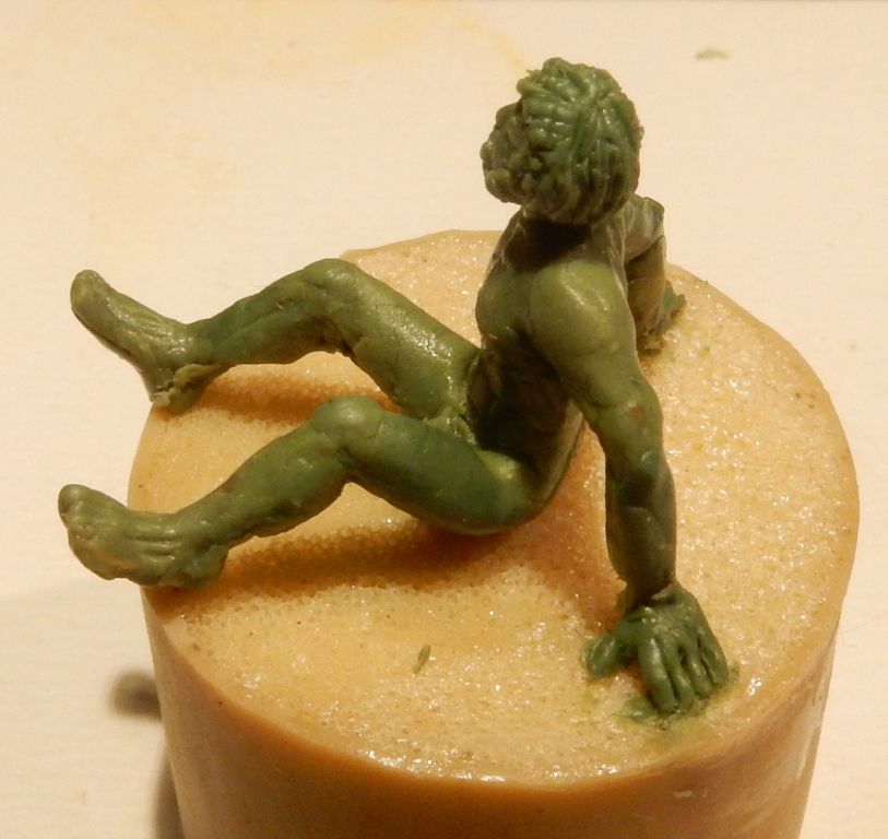

Posted by Mr. Cryns on 08 Nov 2016, 12:52
SPINAL OPERATION
This is a 17th century drawing of a 5th century BC relief that has vanished today, depicting a ships pilot (I think) guiding the steering man, and warn him for shallow waters and rocks under the water surface.
At the beginning of this sculpting masterclass I already prepared a copperwire frame...
...which was covered by a mixture of Brown Stuff and Magic Sculpt:
The cork base is covered with superglue to keep bits of cork from sticking to the putty.
Question 1: a figure laying down has much contact with the cork or plastic base. How far do I have to lift the frame before I start sculpting? Or do I not need to lift it at all since the bottom of the figure will be flat anyway?
When the Green Stuff and Magic Sculpt mix was added, I realised the copper wire frame had very odd proportions. The belly part is much to long. This kind of disproportioning did not happen before. Probably the problem occured because of this man's strange position. Also the lower armpart of the downward arm was too long.
I removed the figure from the cork wit great difficulty:
And cut it in halve with a side cutter:
I removed 1 whole centimeter of belly!
Question 2: how to get those two parts together again when the spinal copper wire has been cut?
I could think of 3 ways:
a) Stick them together with some fresh putty
b) Superglue
c) Two tiny metal pins driven into both halves of the body.
I tried way a)
but after this fresh 100% Green Stuff hardened, the man broke in halve again several times when I used too much pressure.
I used some 100% soft Magic Sculpt to smoothen specific parts and gave him a new face, new hands and feet.
That upper hand looks pretty big, doesn't it? :eh:

Posted by Alex on 08 Nov 2016, 23:42
well, continue.
I think that the primary coating is too thick.
It is rough and sets right the wrong proportions.
I'd Recommend 3 stages
1 primary coating to all parts of Wire (possibly except for the hands) were covered with putty
2 drawing of the main body size (thicker. (Torso, head, the largest muscles.
3 applying putty to finalize the formation of the body.
In general - a pose that "lying" - the most difficult. I do not have a universal recommendation - it is better to do. I think that first it is necessary to make the lower part of the body, adjacent to the base, then good to strengthen the basis of the figure, and then continue with the formation of the upper part of the figure of the body.

Posted by Beano Boy on 09 Nov 2016, 01:05
First of all I wish to commend you on your work thus far Mr.Cyns. :thumbup: You are doing well.
Along the pathway of learning,
innovation of new ideas have to be explored,
instead of keep tripping over the older ones.
Yes I thought upon the questions you put forward,
and came to the conclusion one must do the base first ,
then the guys butt and work upwards too.
I`m no sculptor ,but I tend to look at things with logic.
I am also thinking that you may not want a base to this figure Mr Cryns ?
If that is correct.
You need something between the cork and the figure.
Perhaps make a false base from Oyumaru ?
Nothing sticks to it .
However it will hold your work in place while you work,
and both would easily part.
I will try anything once. ;-)
:mrgreen: "But BB,is a little bit crazy!"
:coffee: I prefer eccentric. BB

Posted by Frankzett on 09 Nov 2016, 10:38
Indeed a very nice figure!!
Well there are a some interpretations of the sea man of the Lenomant relief of the Acropolis.
http://www.theacropolismuseum.gr/en/con ... ical-times.
This man with his rather unpractical clothing shows an Athenian citizen with his cloak cloth in an very similar way we see it on the red figured vases - the citizens with their Athenian cloaks worn on the naked skin. But we can assume that this unpractical dressing wasn't worn with the all day jobs of the citizens and as campaign dress.
We see the cone hat too, may be an everyday accessoirs, but in the history of art, this is a convention to show Odysseus with his cone hat - so this man shows an Athenian mariner, experienced and crafty like Odysseus (- of course!-) on the trireme giving instructions to the helmsman at the aft deck.
And he isn't laying cushy there; we have to consider that all the sailors, hoplites and officers on a trireme HAVE TO SIT DOWN, lay down or have at least stay on their place while cruising, to hold a stable center of gravity.
I agree vith Alex, the first coating with putty is too thick especially at the wrists and ancles, but the problems with the Arms - I think - is the thick double twisted wire of the arms.
And yes the pelvis and waist I think they are the most complex body parts to sculpt!

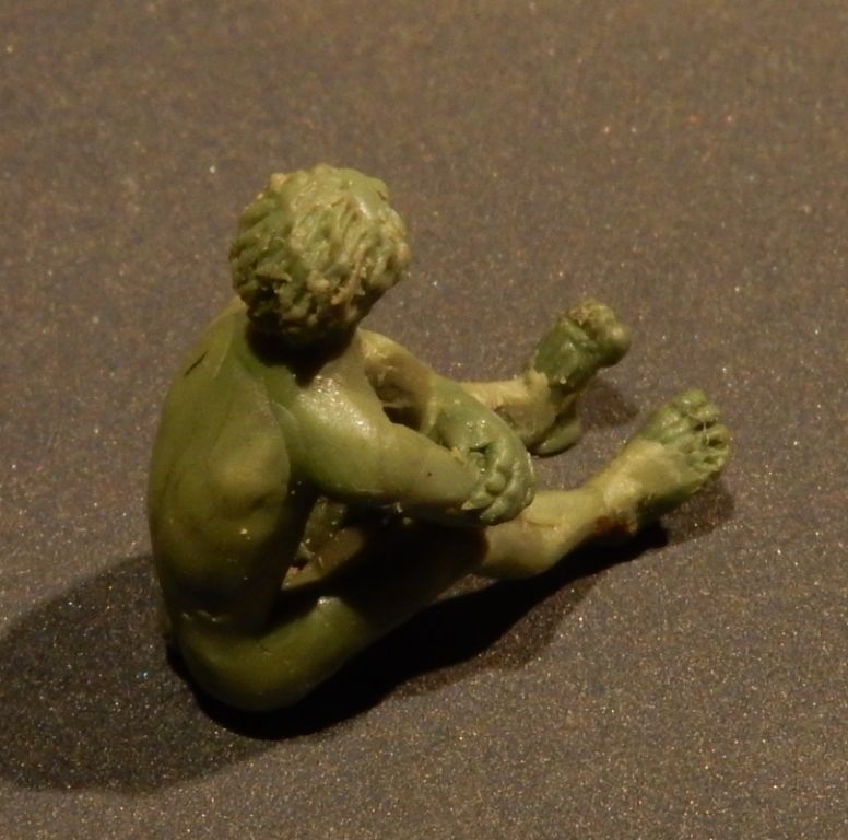

Posted by Mr. Cryns on 10 Nov 2016, 14:17
Gentlement thank you very much for the replies. And for your positive words motivating to continue the long way of learning how to sculpt. I am glad to see I am not the only ones who is interested in the continuation of this masterclass. :thumbup:
Alex thank you so much for the clearifying pictures. It looks like you went to your countryhouse again where your camera was left behind last month. Glad no burglar took it (thats what would happen in The Netherlands if a camera is left behind in cabin or holiday house)
Nice lady with huge ass. :-D :notworthy: :love: But now I wonder:
It looks like her right arm and elbow is sticking to the board.
How do you get that separated again?
My hands and feet keep breaking off the ankles and wrests all the time when I remove my sculptures from both plastic cork and natural cork. I had to fix many of them using super glue. This is a problem that will not occure when a figure has a base or both hands touching body&clothing.
Alex wrote: the primary coating is too thick
Yes you are right I should have removed at least some at ankles and wrists by knife scraping before adding the green stuff.
Alex wrote:first it is necessary to make the lower part of the body, adjacent to the base, then good to strengthen the basis of the figure
Good advice, I will try it this way next time.
Beano Boy wrote:make a false base from Oyumaru
I do like this idea. Did anyone try this before?

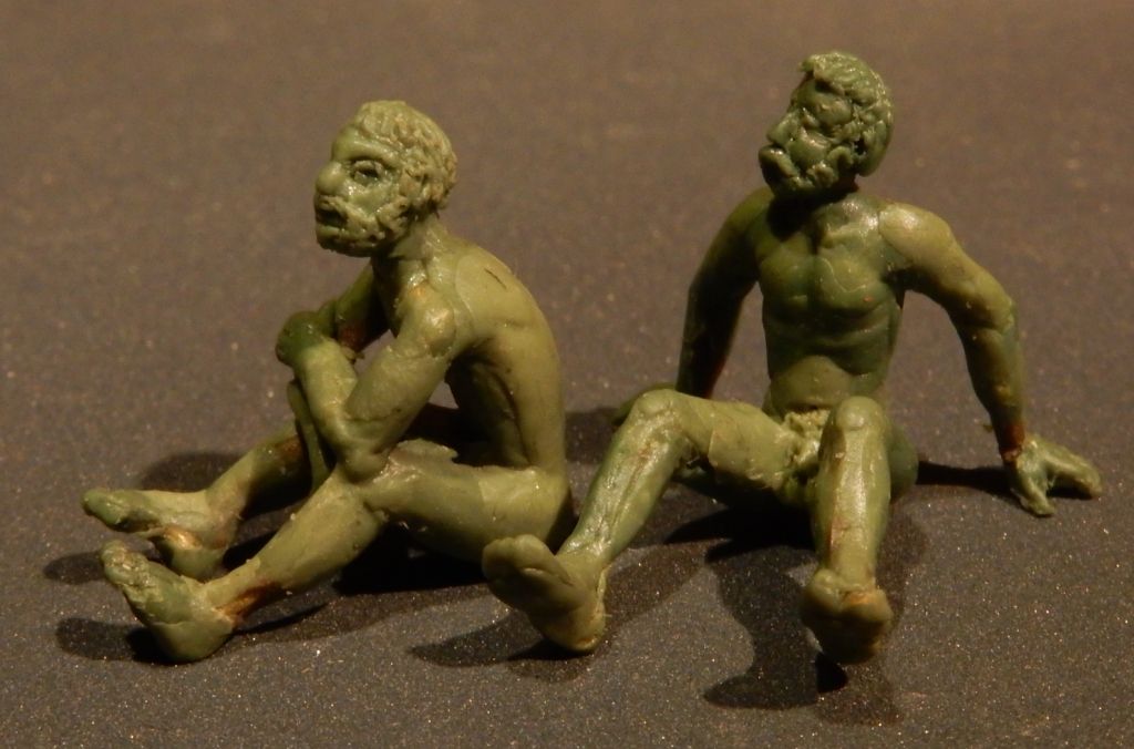

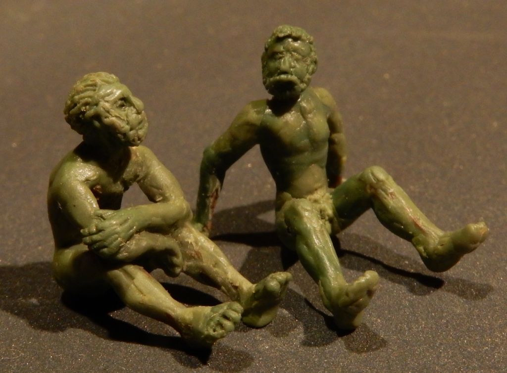

Frankzett wrote: the thick double twisted wire of the arms.
I stopped doing that last month. I am sorry I am still presenting here some double wire frames with brown stuff primal layer that I made already in september before Alex proposed not to do that anymore.
Beano Boy wrote:you may not want a base to this figure Mr Cryns ?
Yes that is correct, all I am making at the moment is figures to add to models of ships, ladders, houses etc.
Kostis already gave me the advice to produce figures with a proper base. But then I have to remove that after casting the copies. If it was soft plastic, that would be no problem at all. But I cast in resin which will make feet and hands break when removing the base I think.
Frankzett :notworthy: for adding historical background. I think I copy that to my Tyrus Topic. There is a better place to talk about those subjects. Only this one I like to reply on here:
Frankzett wrote:HAVE TO SIT DOWN to hold a stable center of gravity.
That is why I made these sitting figures during this masterclass:
When I removed this one, one of his hands broke.
I tried to improve hands and feet. Last night I tightened ankles and wrests.
But then the brown stuff primal layer gets visible and even the copper wire.
These dollies will be dressed soon in chitons or groin cloths.

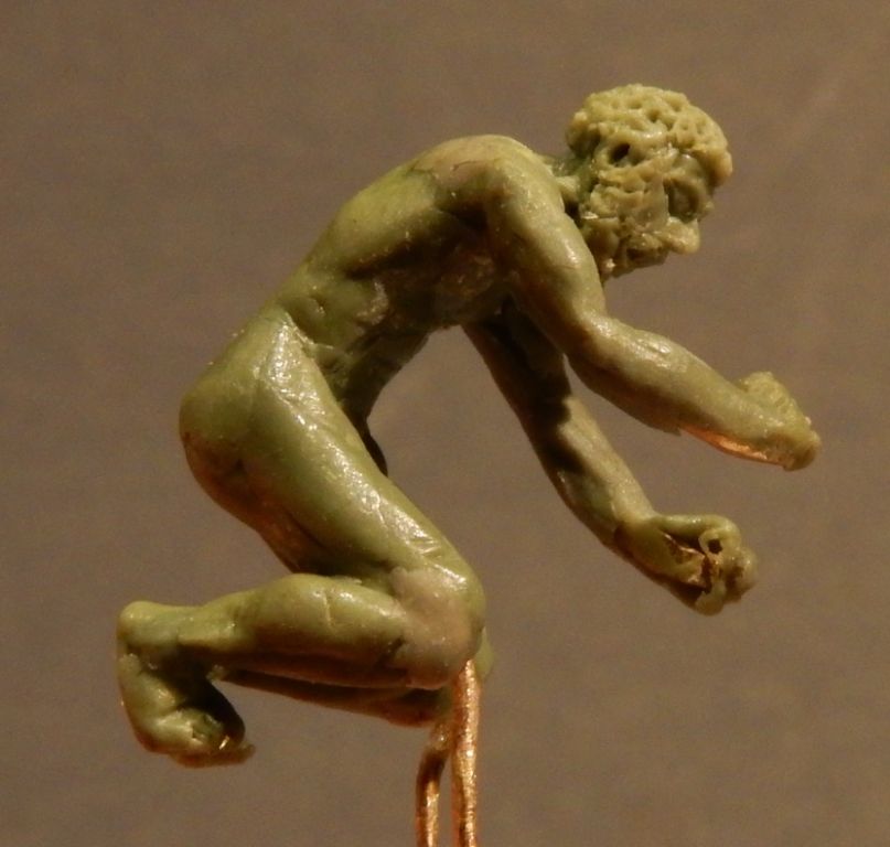

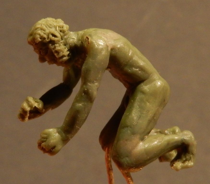

Also I finished my kneeling man that I want to use for untying ropes on deck or cooking a meal at the beach.
Alex your example with the long copper wires under the knees was very succesfull for me. :lol: But now there is another thing:
How to remove the copperwire that is visible at knees and wrests? I can file it with a diamondfile but then the wire may break and the leg gets weak again.

Posted by sansovino on 10 Nov 2016, 17:41
What an impressive amount of work which you have done! I like your figures and theirs authentic mediteranen noses!
sansovino  Germany
Posts: 454
27 Mar 2014, 21:42
Posted by Kostis Ornerakis on 10 Nov 2016, 21:25
First of all a big bravo for for rising standards of your figures. :thumbup:
As far for safe removing from bases use a cutting wheel with your Dremel and cut the BASE as close you can to the figure. Then go on with an apropriate bit to finish. ;-) :-D
Posts: 683
