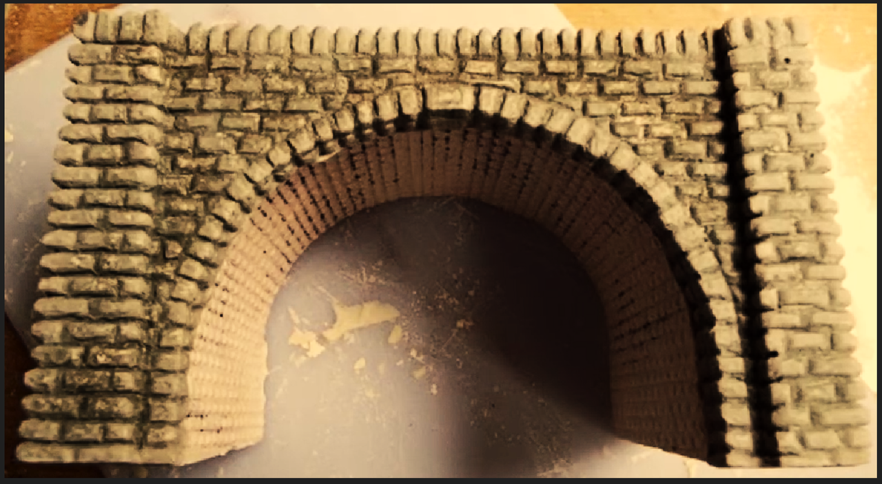

:coffee: Directly high above on view is the inner side of one of my fortified city gates! It along with others need engraving in certain area's and although i do have such a wonderful tool for light buzzing to the average ear drum,but such as i am i cannot do such a thing at this present time.... i am to a greater degree quite busy! :mrgreen: So it will have to wait. :eh: Eh! But BB,ain't going anywhere soon so he'll pick up where whim takes him later.

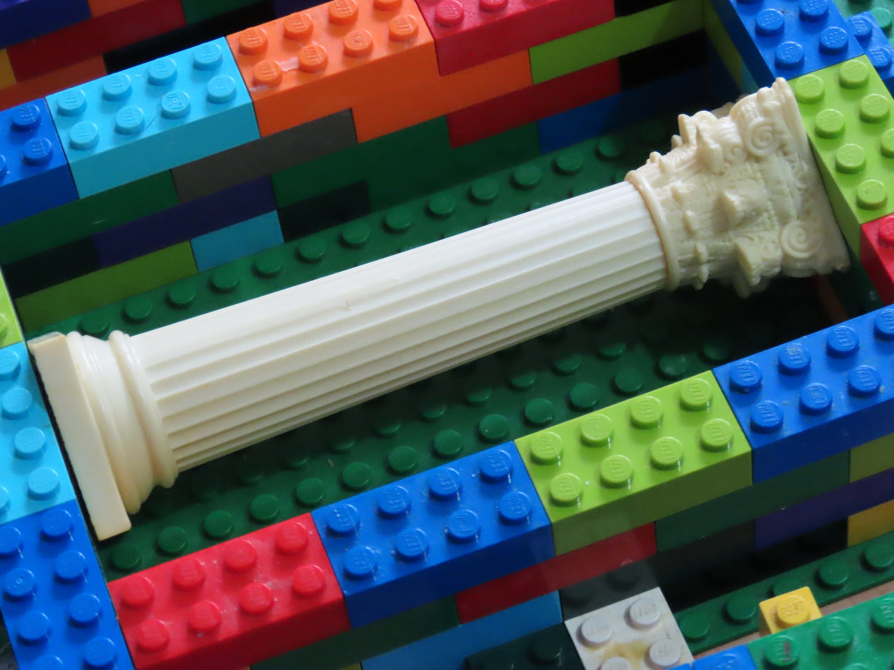

Posted by Beano Boy on 25 Feb 2026, 13:43

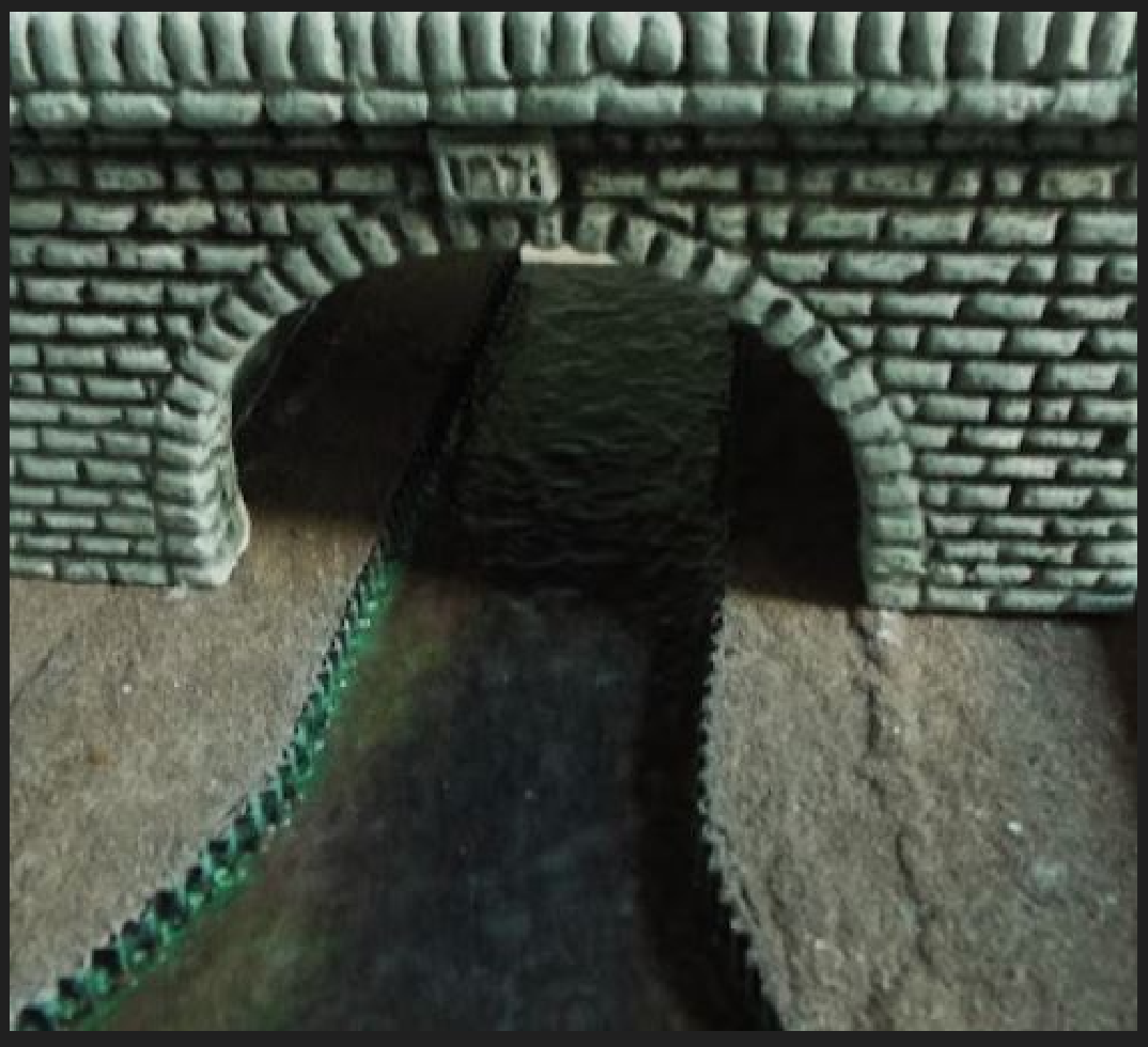

My Bridge & Canal Parts
The Easiest Way That i Know Of
To Aid the Arts & Crafts in Others

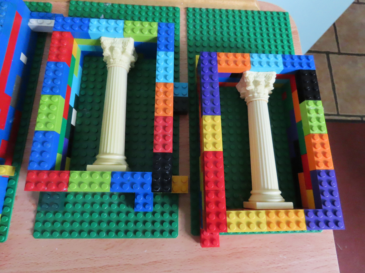

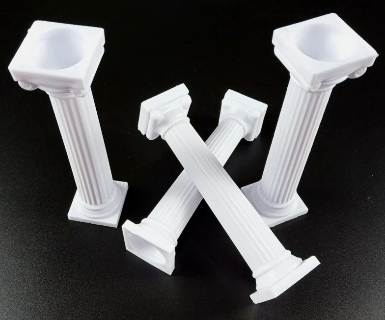

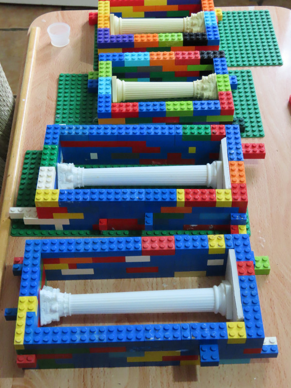

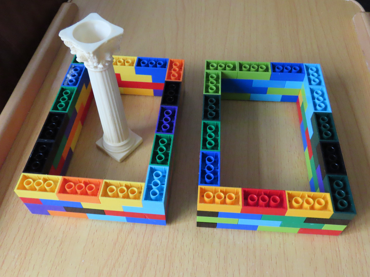

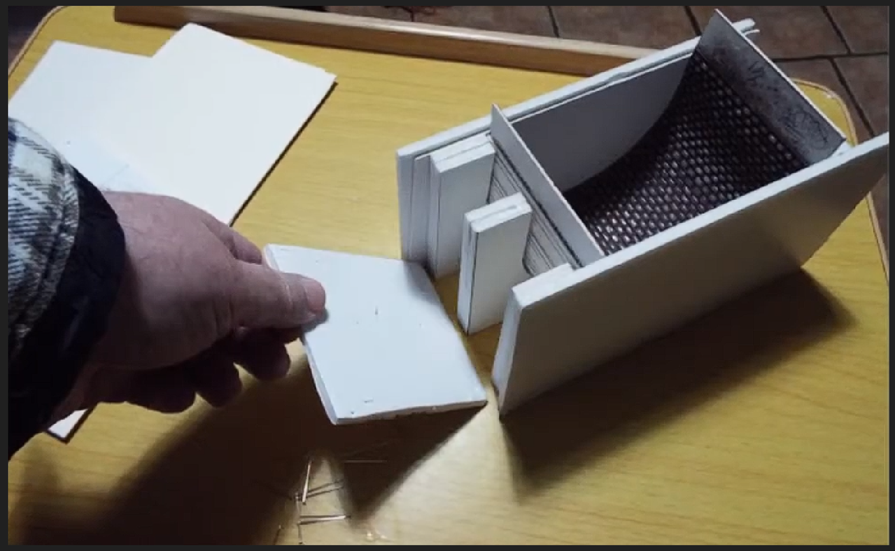

:coffee: The Lego bricks,along with their base and my Patterns were well oiled over with Baby Oil,which i use as a parting agent. :eh:Eh! Why? :coffee: Because it is simply the best product to use. :eh: I must try hard to remember this.
:coffee: My own free style Polystyrene sheet Pattern making process,that is easy upon my hands and arms to do. Unlike that other hard rock-like Blue Styrene stuff that needs a hacking,scraping and deep hard set into place scribing! My Poly... is softer and more plyerble and so is a very easy action of penmanship activity to draw upon. And so no undue stress or pain was placed upon me in my own process of taking care. :mrgreen: Go for it BB,
:coffee: Ok,My o my i do like making a mess! However first a few words of shop safty...Warning Never Wear Plastic Gloves while making moulds. It will end badly for you because silicone is great at sticking to plastic fingers and you will be a well trained westler after trying hard to get free of them. :mrgreen: BB,has been there, :sst: and has done that. :coffee: We all make mistakes but we can learn by them.
:eh: Eh! I never did.
:read: A good grounding bed of Cornflour! :mrgreen: And a streaming out of Silicone and ......
...... :sst: a good squeeze out of baby oil. :coffee: Then i got to mixing it all together using a couple of paper cards to mix it in. Then i used my oiled up hands to make it an oily doughlike dumpling neading it to one hand than back to the other one.
Then it was carefully laid into place and pressed home into each moulding box pressing the air out and lastly smoothed over with... :read: BB's old time Butter Knife. :coffee: It is just a simple song.... :eh:Yes with only a Title... :mrgreen: And with not a single line of lyrics! :beer: i will raise me glass ta that, Burp! :eh: Eh?
:cowboy: This place has turned into a shin,dig! :coffee: : Perhaps Gunnar can supply his own charm of music?
:coffee: Having been well educated upon the head falling off page i desided to twim off the edges in order to make them flimsy but quite capable of taking the pressure of the wet splodge being tipped into them.
:coffee: It all was well worth taking time out to explore what might well be possible with a little patience applied upon the matter.
:coffee: These are very expensive to buy upon the high street or upon the internet,but i being a poor boy found the way long ago how to become greedy!
:coffee: Well you might be able to understand that i always needed more than one,two or even three? :cowboy: But Pard! You pass the word along to others...
:sst: so others can become greedy in a good sence of the word.
:read: And so it was recorded in BB's Journal what was needed next... :eh: But what is it for?
Until the next part i'll leave you with this. These are 20mm Figures made from a simple single silicone mould. Fantasy is what one can make others believe is possible without upsetting them. BB

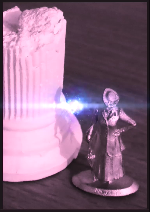

Posted by Beano Boy on 26 Feb 2026, 20:25
:coffee: Many years ago i bought a whole set of these that were on sale from America on E Bay,upon that sale the information was that they were from a well thought of collection that had held up a very large wedding cake way back in the1970's. i won the Bid,and as soon as they arrived i began making the silicone moulds. One of my casting's which is seen here is of a fine tall Greco Roman Column, half of which is still within my first mould. The other half of the silicone mould lay on the table top to the left.When things reach a certain stage of success the smile can be from ear to ear. :thumbup:
Stay safe,stay well,
and help others if you can.BB

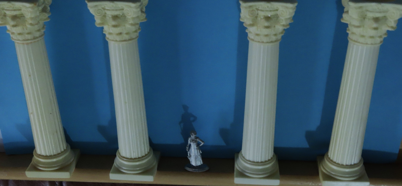

Which scale do you think has your column, Paul? It is really good looking!

MABO wrote:Which scale do you think has your column, Paul? It is really good looking!
I completely agree with Jan that that column looks very good, BB. :drool:
Taking BB's hand as a reference, I think it would work perfectly for a 1/72 scale model of a good-sized temple, Jan. :mrgreen:

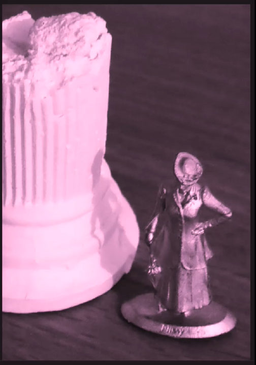

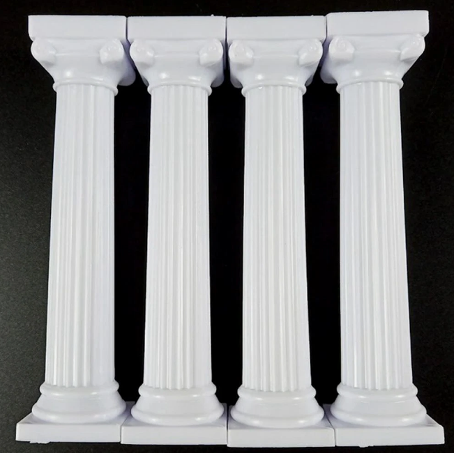

:coffee: Well Jan, figures 20mm or 1/72 scale would be cool for my unusual 8ince column,most are only 6 inches.
Sberry,thank you for your interest and question. :thumbup: you are a good fellow. :beer: I'll drink to that. Burp! :sst: that guy is drunk again bb. :cowboy: He'll have to go! :eh: I sort of like him because i take his empty bottles back to the Pub,and they pay me 10p for each one. :coffee: Now then i must get on guys...Although the columns i used as pattern's were bought when i was a lot younger they are well over 75 years old.
So no copyright upon those, however i determined long ago never to let my hobby become my living, because things get lost and get broken in the post and simply put i do not need such a demanding thing. It is my delight and happiness to show part of the way to help others but i don't wish to sell or trade them.

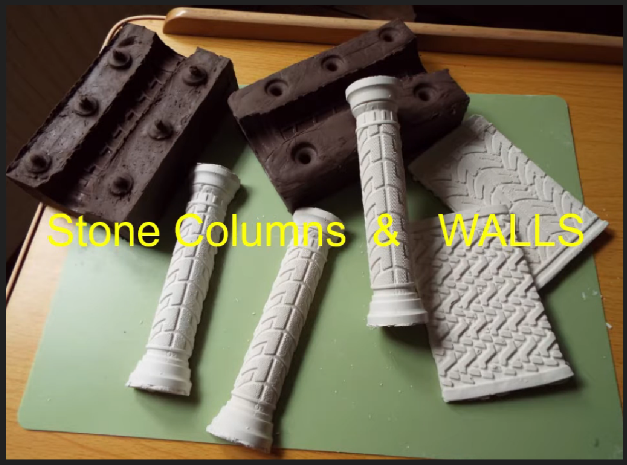

:coffee: And so upon a whim i developed these columns too and flat walls and thereby produced my castings from stuff i poured into my silicone moulds. i guess some might well remember what they were made from? It certainly was an unusual item of which there are many designs. Designs that we might see but never realise their potential in the arts and craft world of make believe.
:read: He! he! Yes,they were once Bike Handle Bar Grips!
:mrgreen: :eh: :sst: :winky: :beer: :cowboy: :coffee: they sure were,they all agreed.
:coffee: Here below are things that make sense to use for high rise pictorial adventures!
:coffee: For all those interested in the shape or form of those on show above. :cowboy: On E Bay Pard's just google Roman Column's for Cake Stands. :mrgreen: They are cheap as chips, but that depends upon ones own project size and layout! :eh: But i only need one BB. :mrgreen: Well that's tough WingNut, because now you'll have none! :sst: they do come cheaper by the dozen and plastic is still pretty cool to use upon what ones dream is.

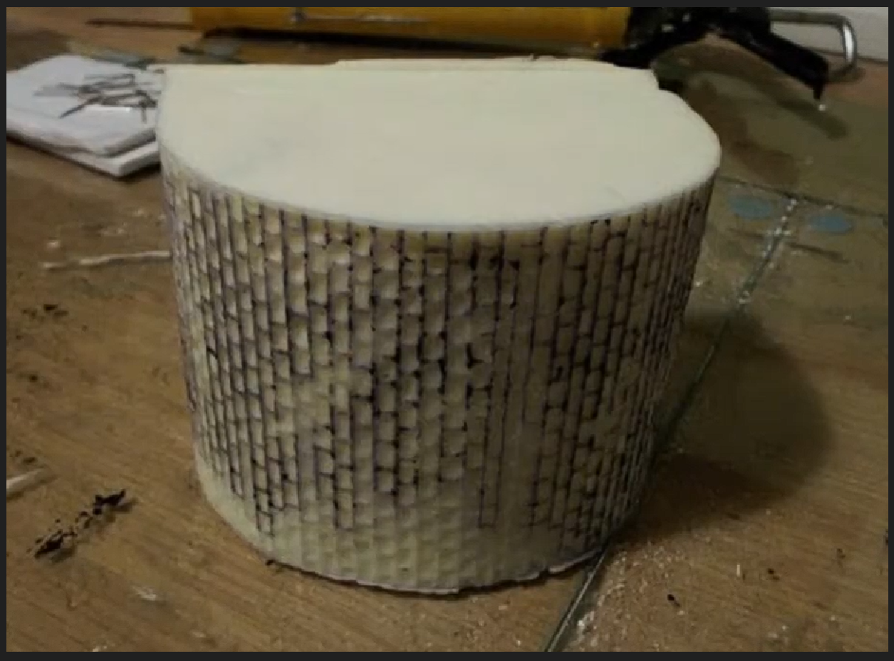

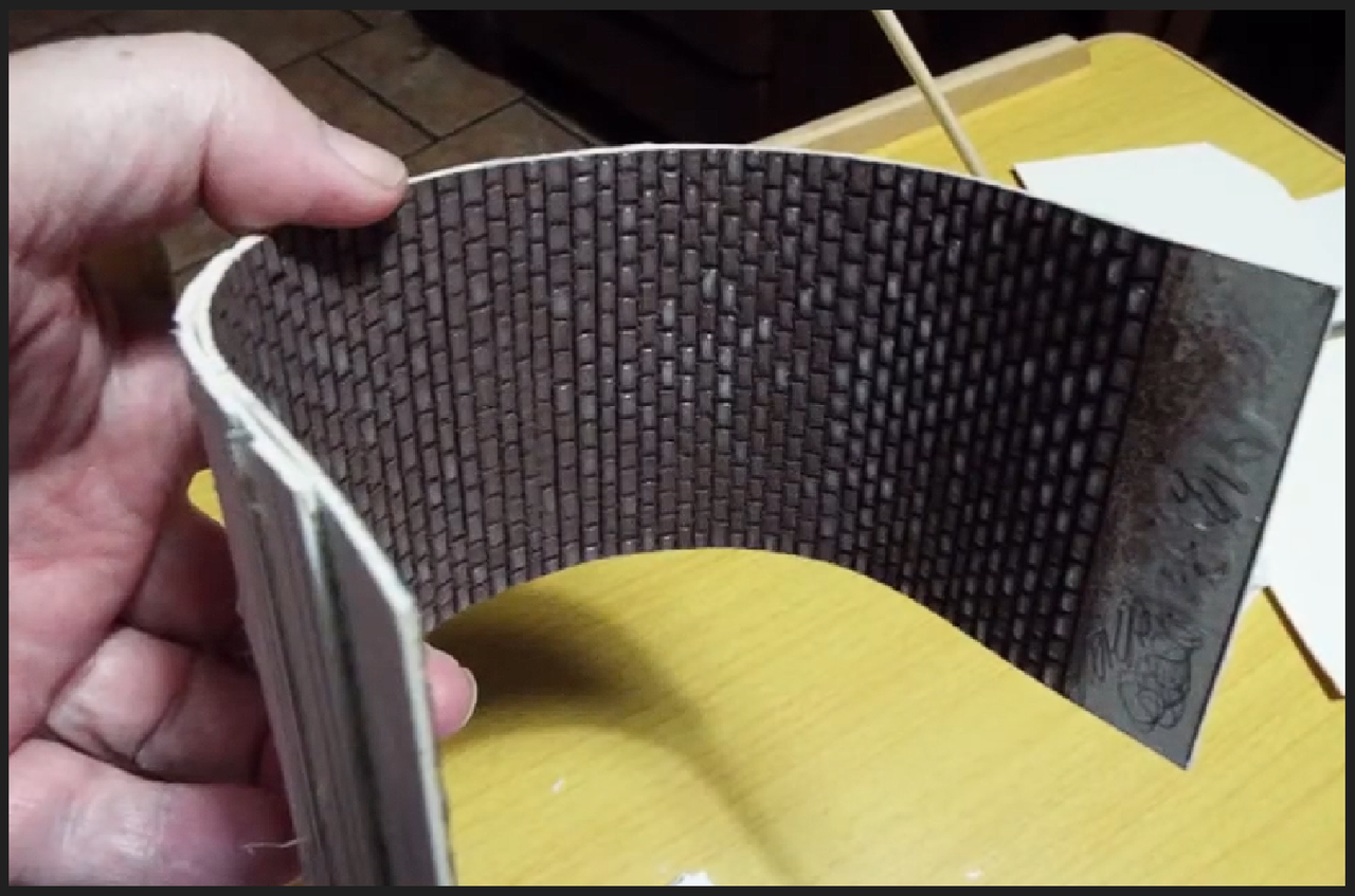

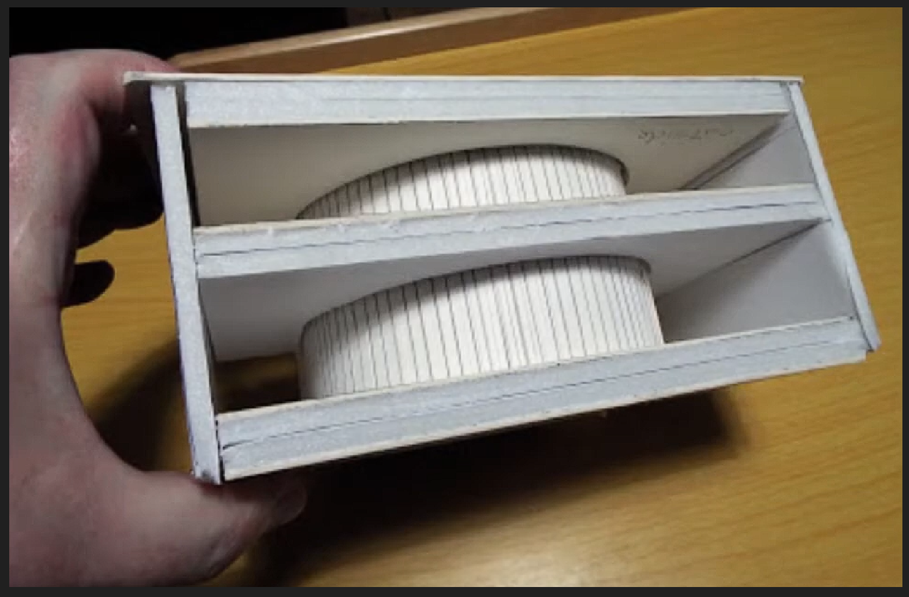

Posted by Beano Boy on 13 Mar 2026, 02:19

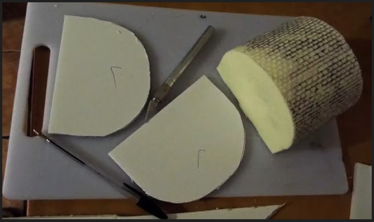

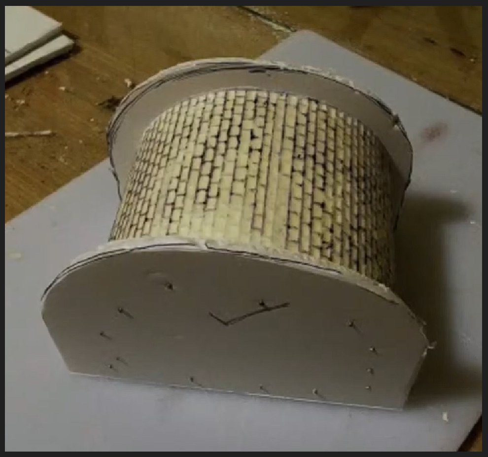

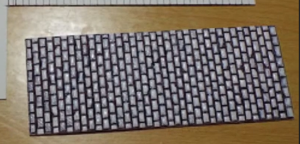

:coffee: My old and trusted method of drawing to scale brickwork. The fact that each brick had been raised above the morter line that lay between each one. By way of using thick P V A Glue globed on by way of a little brush in order to do a very unusual thing! :sst: patience is a virtue. Mentioned the little button.
:coffee: The photograph above reveals a simple core box cradle made with scrap paper card and held together with dress makers pins! :mrgreen: This is the up side down doodle of a camera shot. :eh: Eh? :mrgreen: WingNut, seemed his usual self as he viewed this oddity!
After the final angled pins were set deep firm into place It was filled and then...

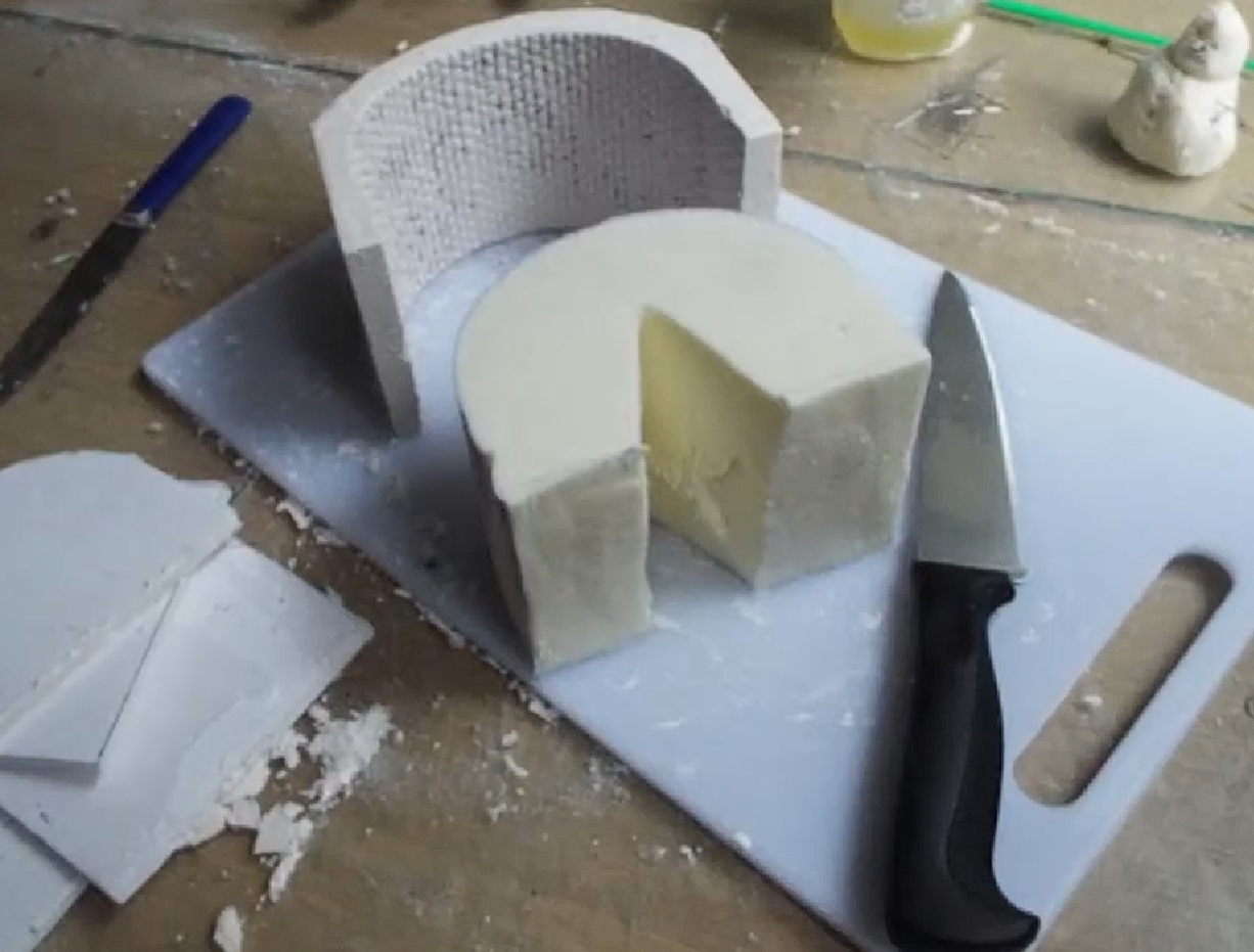

:sst: What it produced was a silicone core pattern. :eh: Eh, what? Asked WingNut.
:beer: It's ha!ha! Ha! Lump... Burp! :eh: Yes i agree he's got to go.
:mrgreen: It might not be what you think?
:coffee: i'll see you perhaps upon the next part,
Until then take care and stay well,and yes help others if you can. BB

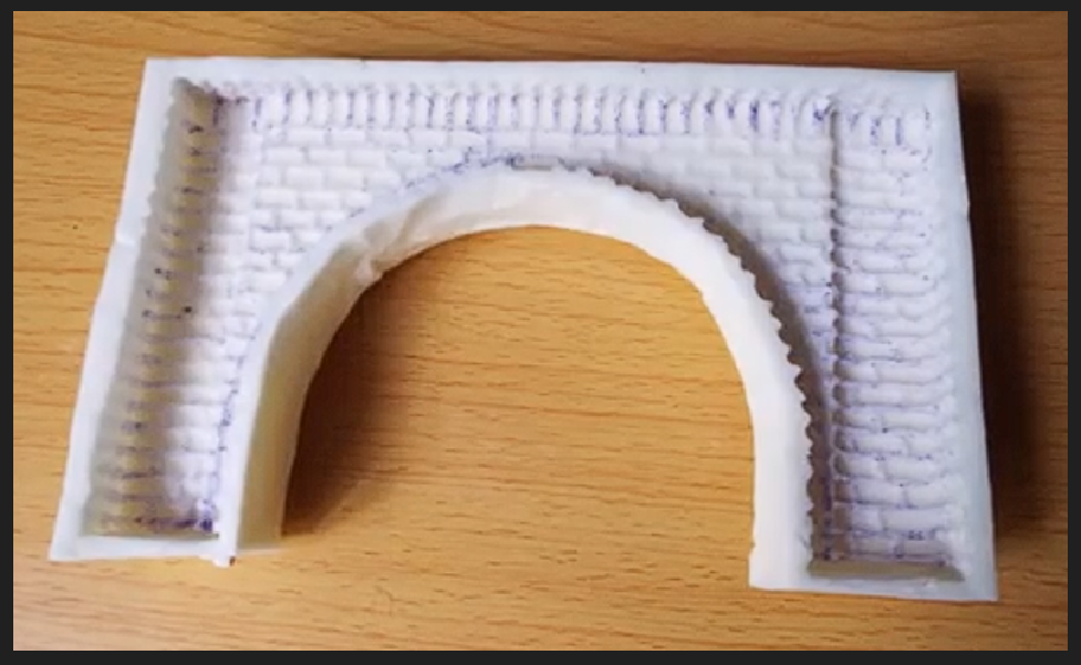

Posted by Beano Boy on 13 Mar 2026, 12:47

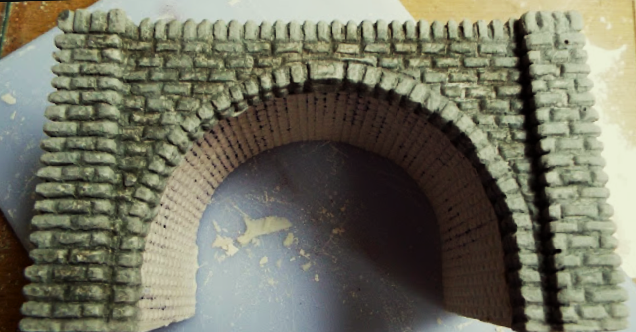

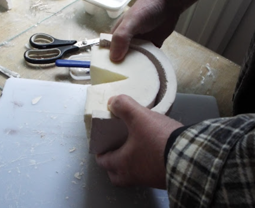

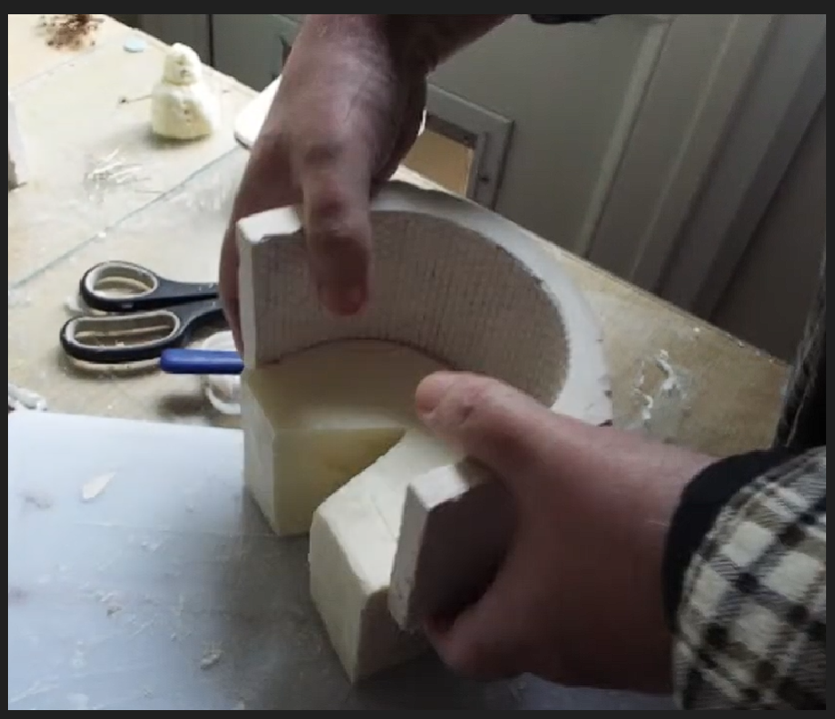

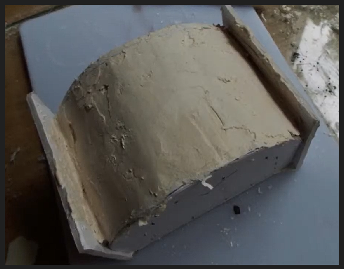

:coffee: What was made in the core box,was the inside pattern of my bridge parts,a sample is displayed unpainted. Many years ago i made a water way canal with bridges and tunnels at each end. :eh: Eh! But how did that lump produce that bridge part ? :mrgreen: It's a puzzling mystery!
:sst: well it is hardly one of those because bb is going to reveal it and show the way. :coffee: Hmm!... i am?.. O, yes of course i am. :mrgreen: It may not be what you think? :cowboy: Well Pards,the builders have arrived to finish BB's Wet Room!
:coffee: OK! i'll get bact to you all later. BB

:coffee: Hi Guy's i'm back with the next photograph which hopefully can be viewed above? :sst: see i told you that bb,will show the way of it. :mrgreen: But what is it? :eh: It's the lump with two sides added to it. :mrgreen: It's a BB,pin up! :sst: don't be silly its a humpty thing a me jig! :read: It is a core box with the pattern inside it. Replied the little book worm. :cowboy: Yippy! Cried out the Cowboy,who seems to have quite a loud voice.
:coffee: Corn flour and Silicon plus Baby Oil,mixed this up fine smooth and Dandy,for a small lad as little me. :mrgreen: bb,is a very large man who writes sci fi fiction! :read: Which means he gets to lie every day. :mrgreen: Yes very true!
:eh: Eh! :drool: That can't be,can it? :coffee: Of course it is it is fiction!
And so it was the core box pattern was well plastered over into its final shape, and with the pins removed along with the sidings a free standing shape was easily removed. :beer: !'ll drink to that,cause i am well plastered, Burp!
To ease the removal of the casting i removed a good wedge of solid silicon, by using my Mrs B's sharpest kitchen knife.
:cowboy: :-x :read: :cowboy: :sst: we love it when a plan comes together.
''Paul have seen my large sharp kitchen knife? '' :coffee: Opp's! :mrgreen: BB, will be in the dog house again.
:coffee: Well this process being a universal pattern for the inside of more than one bridge part. Other castings produced in the same way were included within my other canal bridges.

As the column's cast their shadows upon such a blue....
:coffee: Missy,of course did not find Sir Percy's Library,but arrived in a most wonderful place within another time zone far into the future of 13/03/2026.
:eh: O'my! This is getting very deep for my little head with lug's made for twisting!
:coffee: Of course WingNut,is kind'a special him being like a Tigger, after all he too is the only one.
:coffee: As for my self i set to.To sort out my Lego bricks for that which i would need once all the banging'sawing and sounded working man's boots stopped upon our stair case steps. Those working guys were very able at what they were doing and were very friendly too. Mrs B,plyed e'm with tea and biscuits as they beavored away doing my wet room to suit my special needs.
:mrgreen: It might be the case,we are all going upon an adventure.:cowboy: Well Pard's,me and Cyclops are certainly up for it. Sounded out the Cowboy upon his ancient one eyed invisible steed. :mrgreen: He always looks as if he is riding a broom stick! Chuckled out Mr Green.
:sst: yes,there he goes upon his two galopping legs! :eh: Well i cannot see anything! Wingnut said as the dust of such an invisible steed was kicked up upon the high wind of complete utter change.
:coffee: Here i began, and did build up the double boxes that would house my slender elegant pattern's! i am so lucky charmed with being able to see all that which needs doing before starting this project. This one might be my last as i am very ill,but shucks! i aint dead yet and the quest to make do still continues on.
:coffee: It was soon realised that i would need to add a piece of styrene just to fill a small space beneath each footing.
:coffee: Now as you view these things boxed in...all is not what it appeares to be.
It is not a mystery though and i will reveal the eventful outing ahead.
