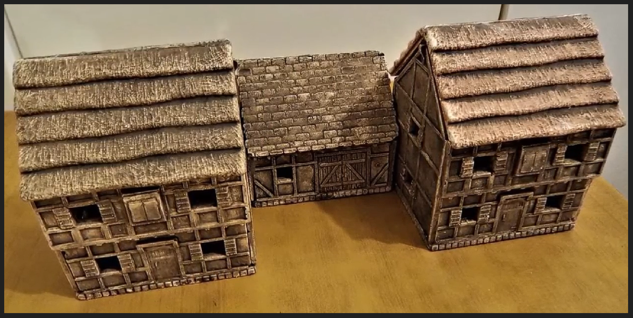

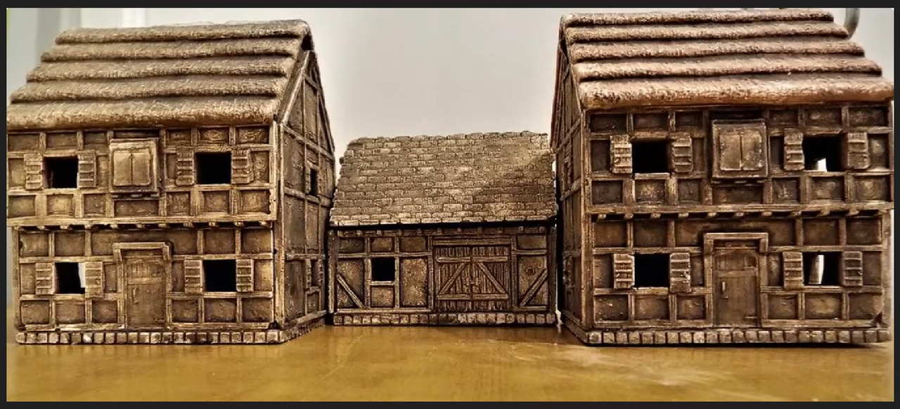

:coffee: And so it was a few more casting were siliconed together which made it very quick and easy to do...... after all it was all worked out well before they were removed from their moulds. Planing ahead of Time i like to call it.

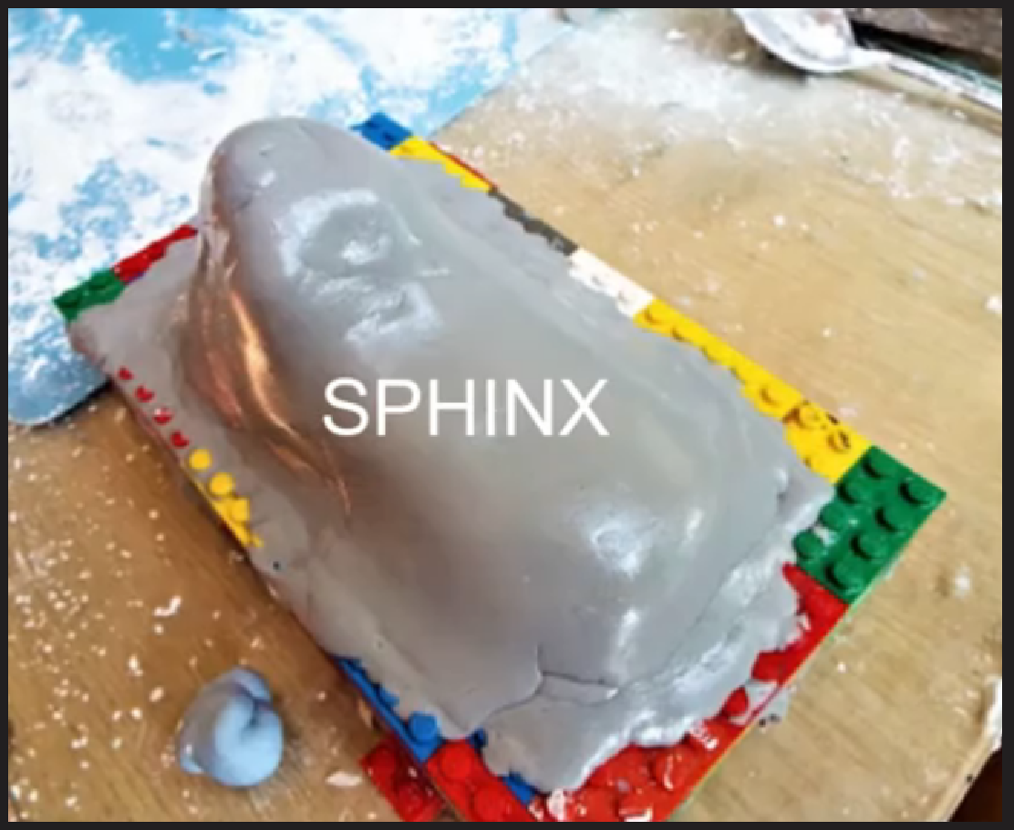

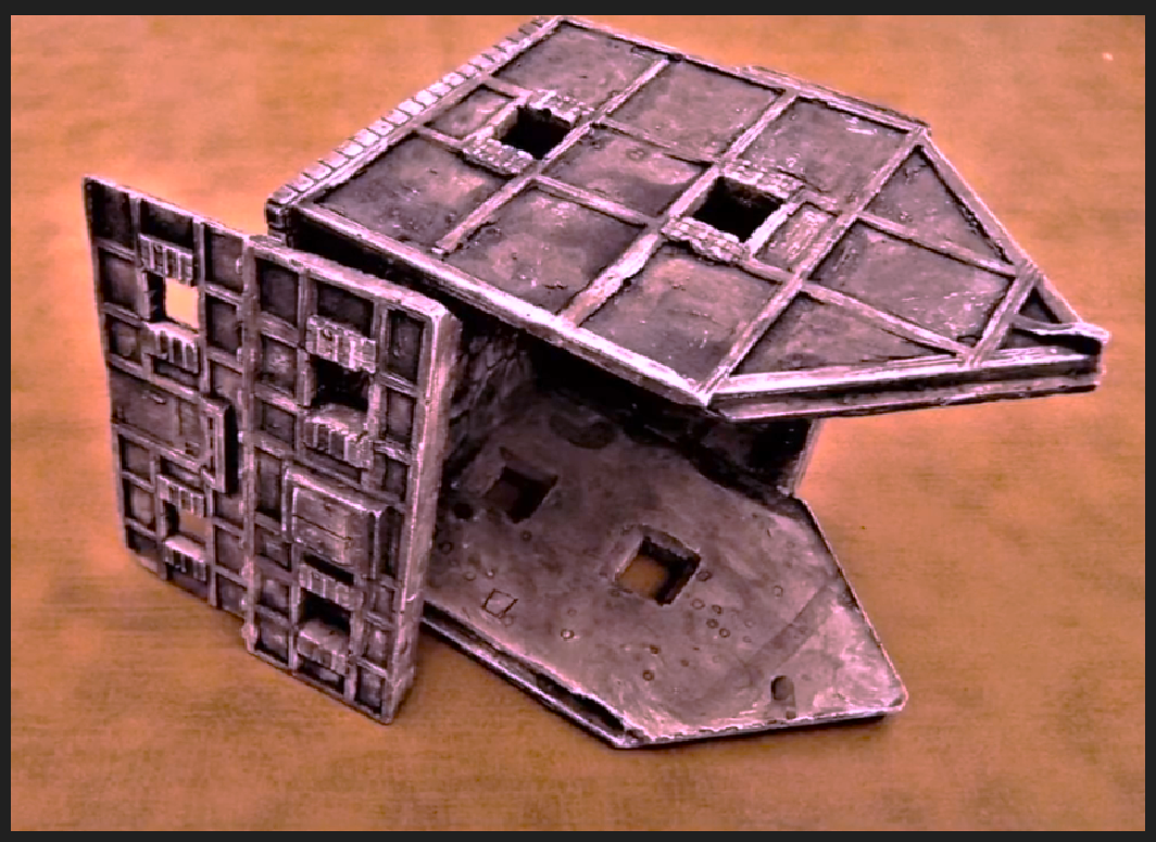

:coffee: It was both interesting and challenging too,because i needed what i would term a 'cradle mould', which was certainly a test of my abillity to formulate such a thing! :mrgreen: However all did not go as BB,had planed! :eh: And funny things got out of hand.
:read: Well one has to laugh some time...
:coffee: So why not now?
:coffee: So once more i applied the 'Chaos Theory ' within my world of arts and crafts. :read: It mainly is the Science of Surprise!

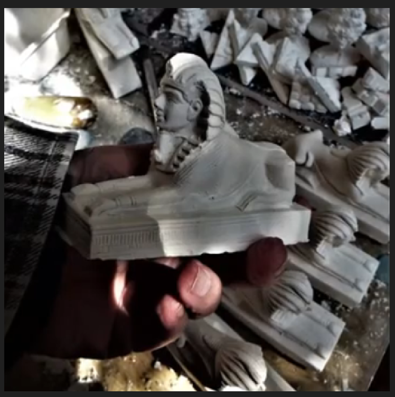

:coffee: And so the big day arrived when..... Thud! Happened.
:coffee: :cowboy: :mrgreen: :sst: :read: Surprise!

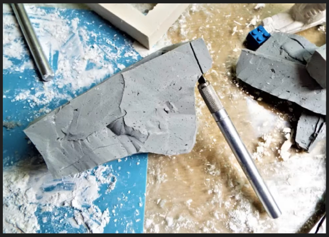

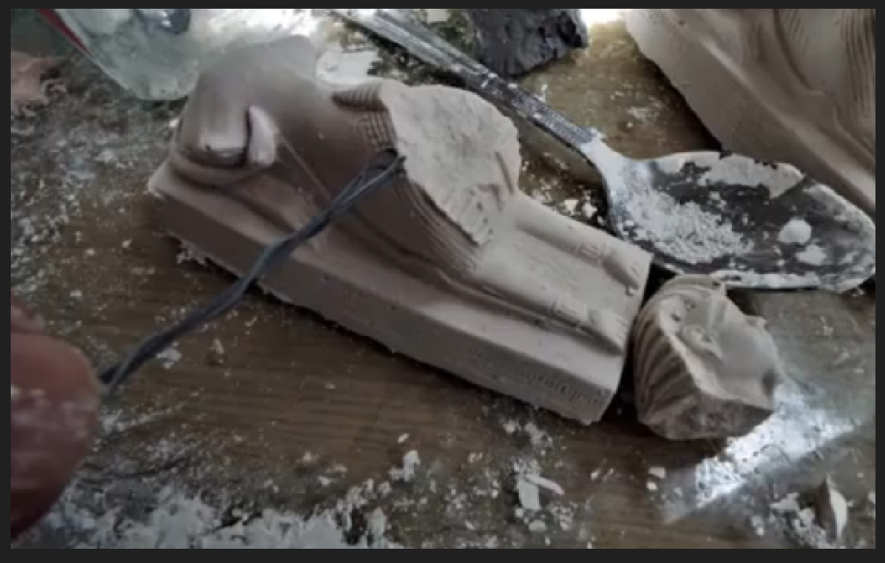

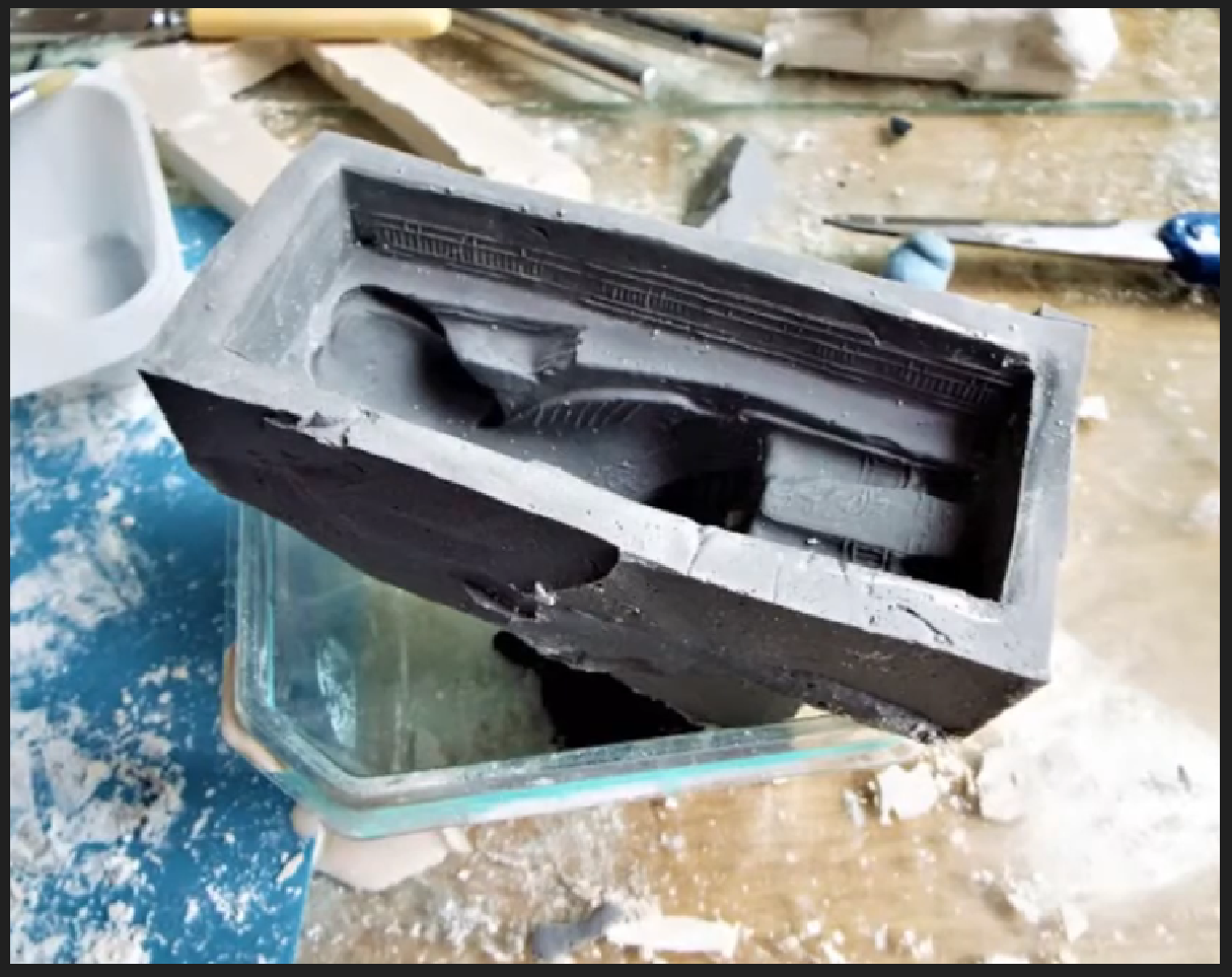

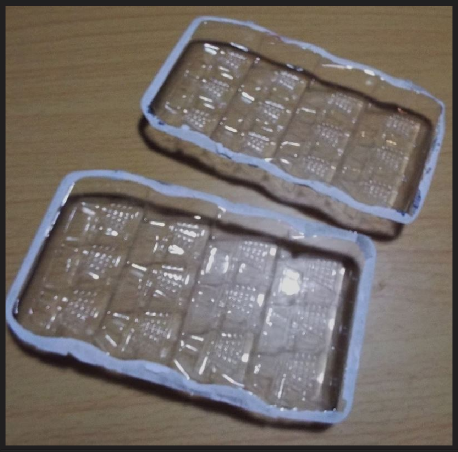

:coffee: And to counter that happening again i trimed the silicone mould down with my craft knife. :mrgreen: Crazy BB!
These are the trimmed off pieces and now the silicone mould will be a little bit more flexable instead of rather stiff.
:mrgreen: No more twisted off heads please. :eh: It were a sight that scared me stiff.

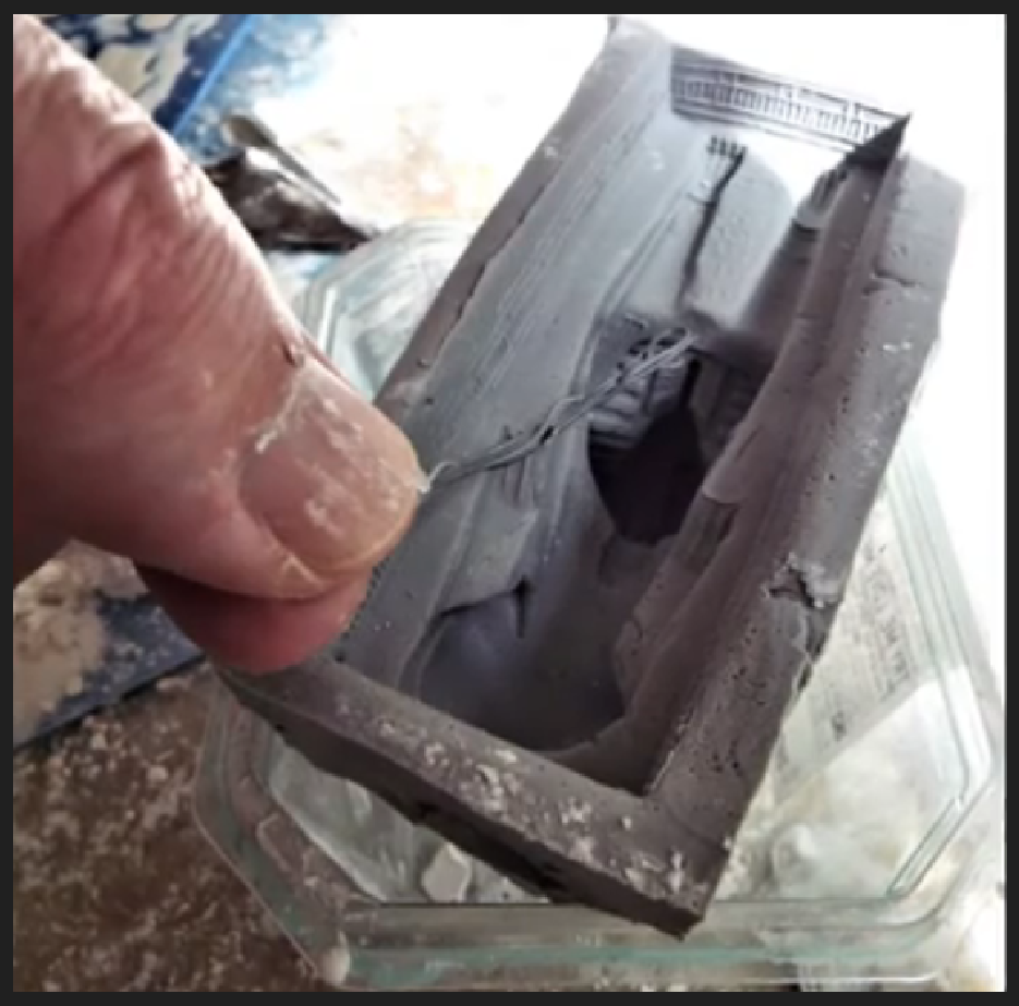

:coffee: And so i tried again after placing the mould upon the box which is just an empty plastic container.

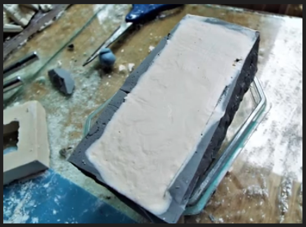

:coffee: This time with a sprig of twisted wire! :cowboy: Well Pard's that's one heck of a neck job. :read: the neck bone was pushed into place after that place was full of bb's casting up splosh!
:mrgreen: Then the rest of it was cast up level and true.
:coffee: And so it was production began once more with not another one losing a head. :mrgreen: :eh: If we were on You Tube,and heads started rolling about willy nilly they would rate us with a great big X... :eh: Would they? :sst: they would most certainly do it. :read: never mind that,things are starting to pop around here. :beer: I'll drink to that! Buuurp!

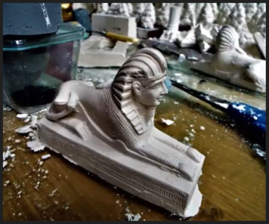

Wow, Mr BB, you are tireless with your silicone mould creations; it's clear that you enjoy it. Those sphinxes in particular look fantastic. You've done a great work! :drool: :drool: :drool:

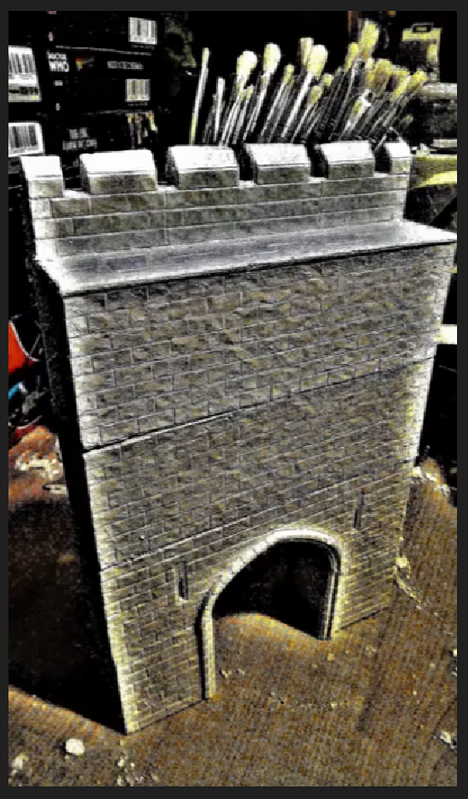

:coffee: Directly high above on view is the inner side of one of my fortified city gates! It along with others need engraving in certain area's and although i do have such a wonderful tool for light buzzing to the average ear drum,but such as i am i cannot do such a thing at this present time.... i am to a greater degree quite busy! :mrgreen: So it will have to wait. :eh: Eh! But BB,ain't going anywhere soon so he'll pick up where whim takes him later.
