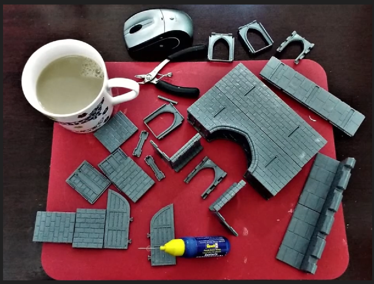

The Lego bricks were being collected after drying them,and this time a three part mould would be built up in stages. But a nice cup of tea arrived from the kitchen via my dear Mrs B, who smiled the smile of understanding as she looked at the work table with needful things piling up which were needed by my good self. Once again i would be employing the Chaos Theory again in my Quest to make a certain something. :mrgreen: Which is going to be such a mess!
And so it was soon after slurping my tea,that the silicone was squeezed out upon the corn flour, it being starch that now needed baby oil added to it in order to help blend a good mix for another moulding adventure to begin. Baby oil is not cheap,and cooking oil is cheaper. However that can also be used,but there is a lot of sugar in cooking oil and it will seap out of any mould and make them very sticky indeed. Yes i know this to my cost.

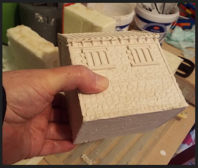

This building would be the cheap Pattern and passage leading to somewhere else.
This turned out to be a three part rubber mould.

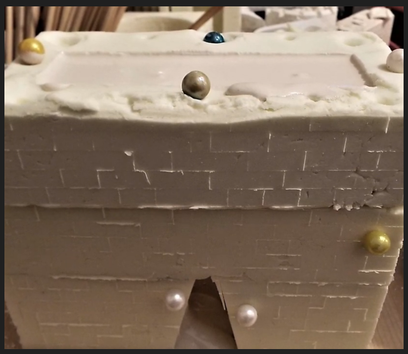

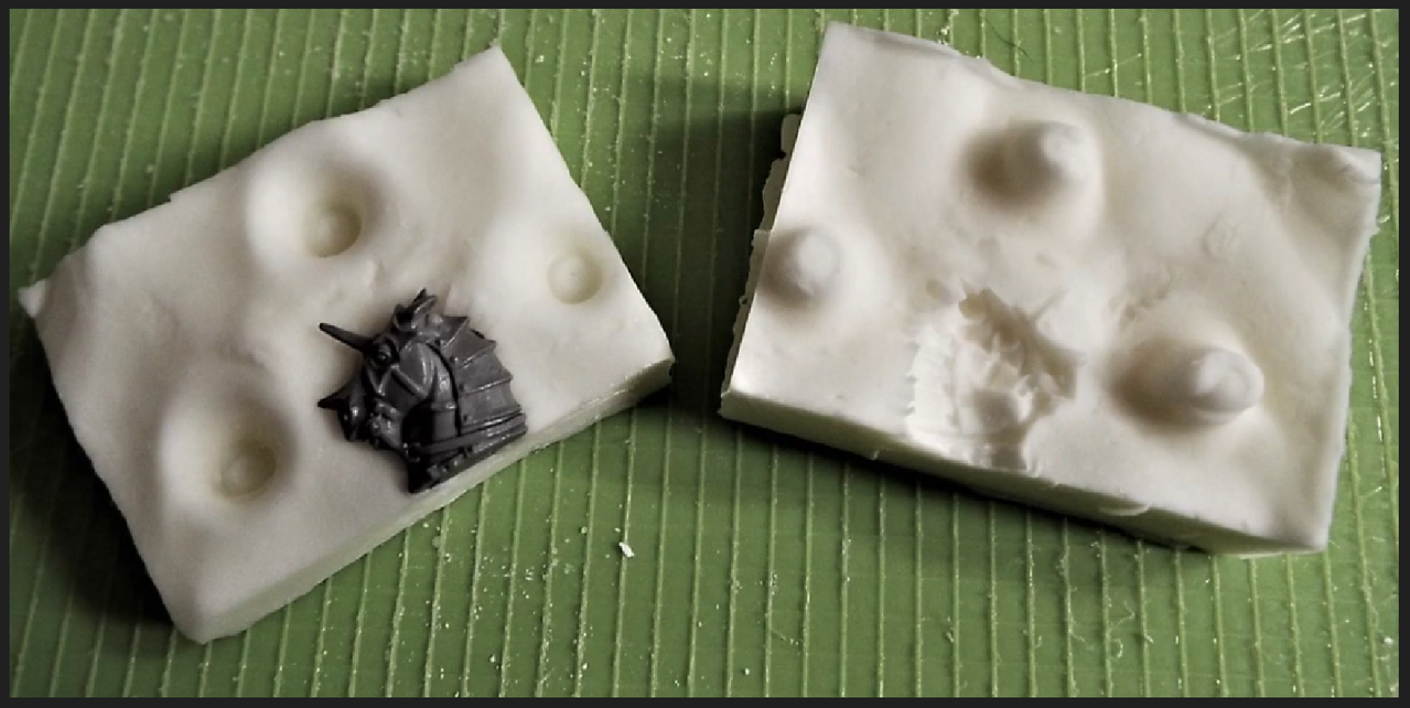

The guidence pegs will fit snugly together settling into their guidence holes which means that there is only one way to put it all together ready for pouring my resin into it. i went forwards by using very long hat pins to reconstruct every mould which were fixed tight inspite of pouring my resin mixture into them.

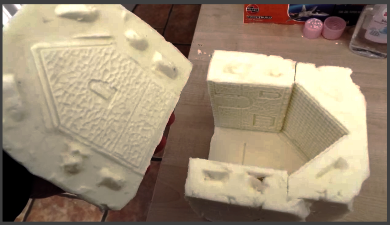

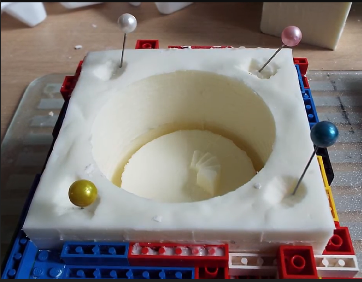

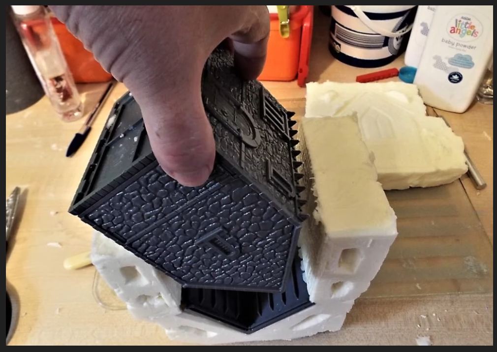

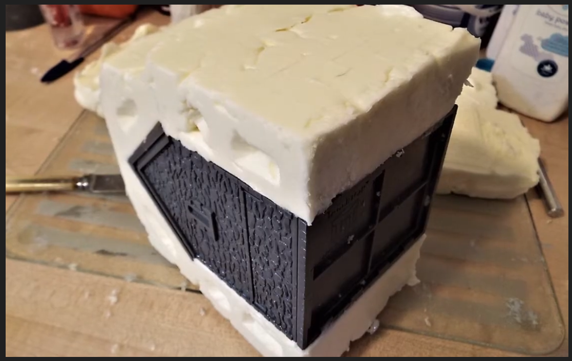

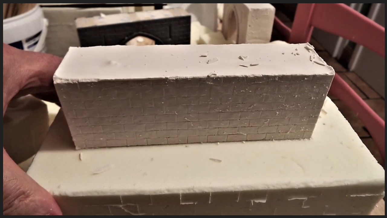

These are my newest plastic bricks,and some of these formed the multi part moulding box.

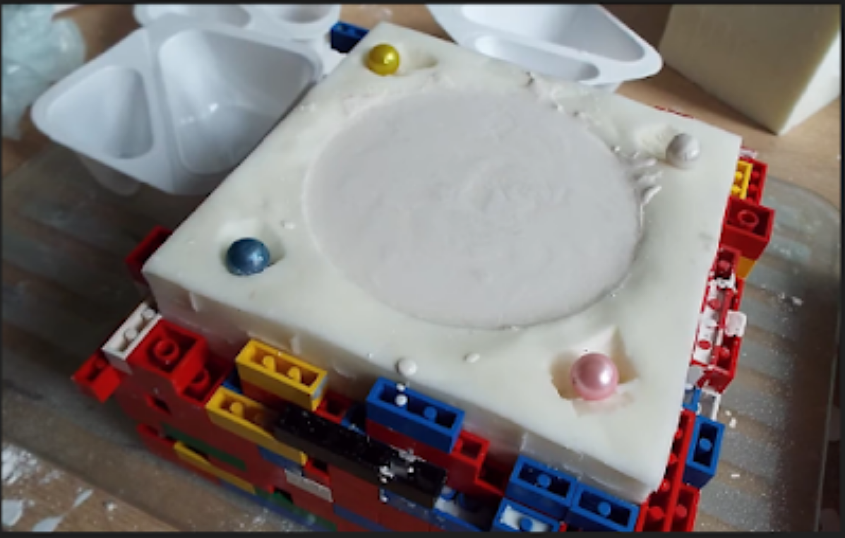

The mould being four sides and the top way down in the bottem,and i must admite it did look rather odd with long sized hat pins holding everything in place.
The very long sharp pointed pins that held everything together were removed ...

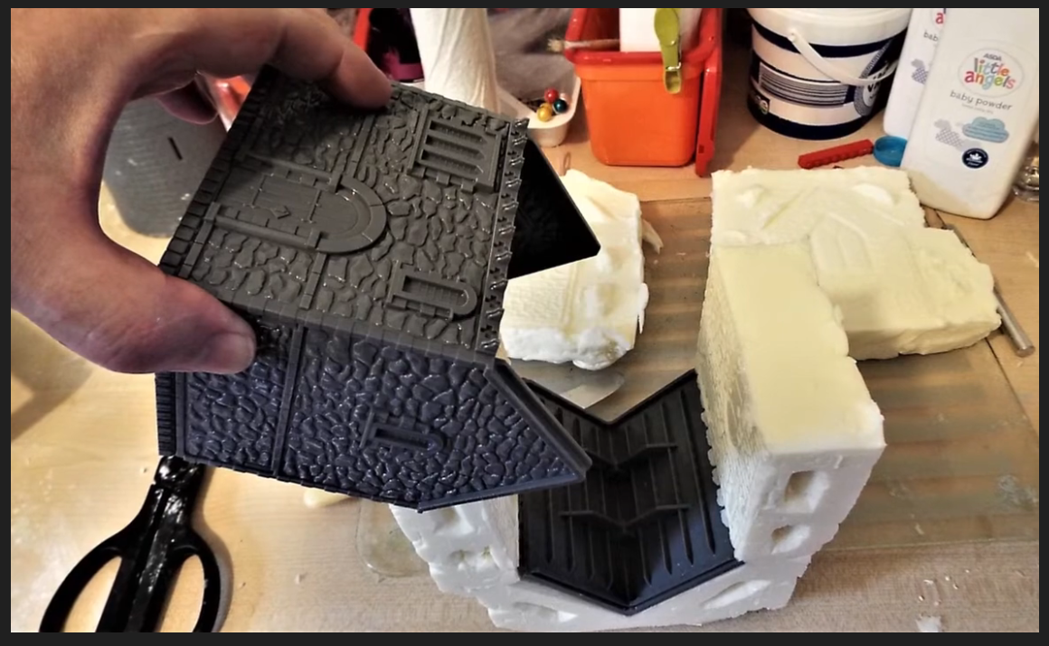

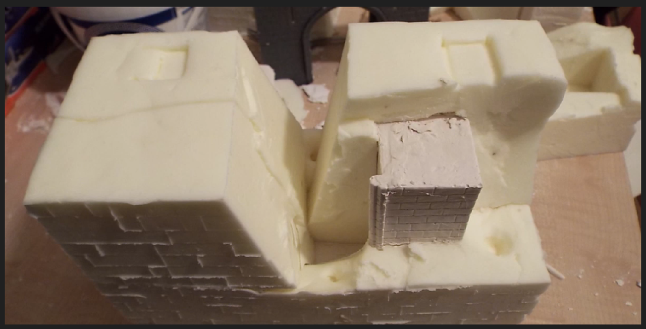

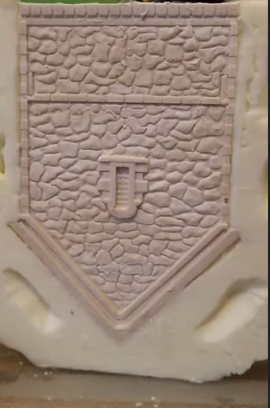

And the loose roof pattern remained in the bottem which was as i planed.

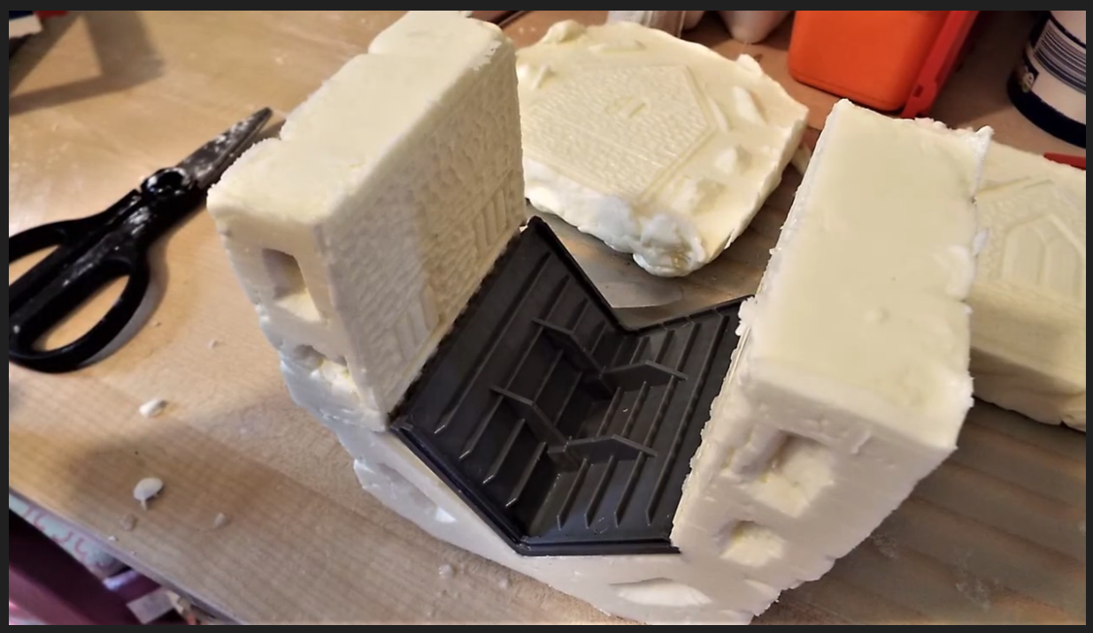

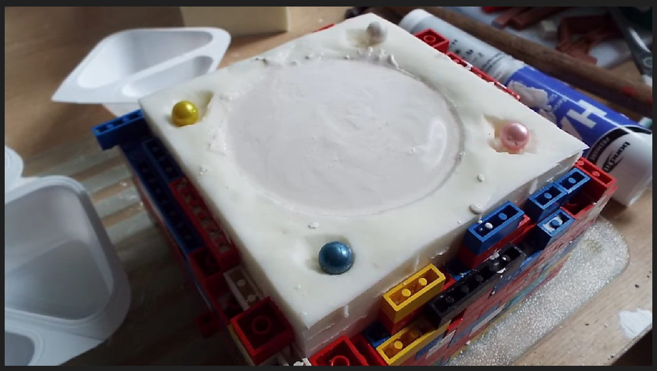

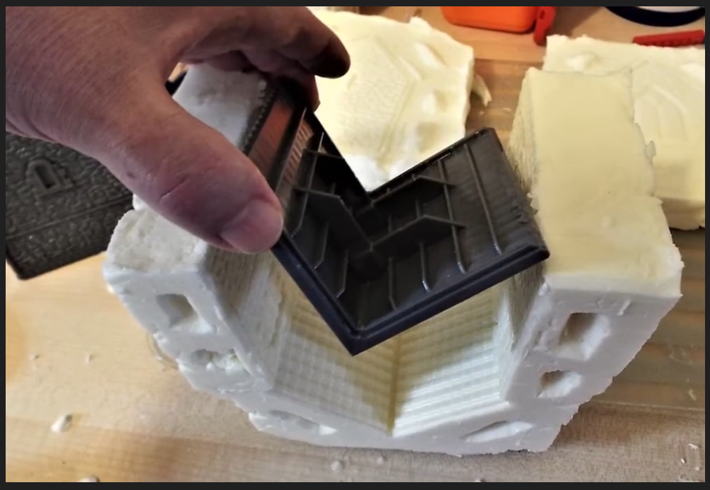

So removal of the four sided pattern took place.
Often is the case within industry loose pattern pieces are designed and used to avoid damage to the mould as the main pattern is removed.
i desided as the roof overhangs this structure, it would become a loose pattern.
So with a little flexing it was removed safely without ripping the silicone.

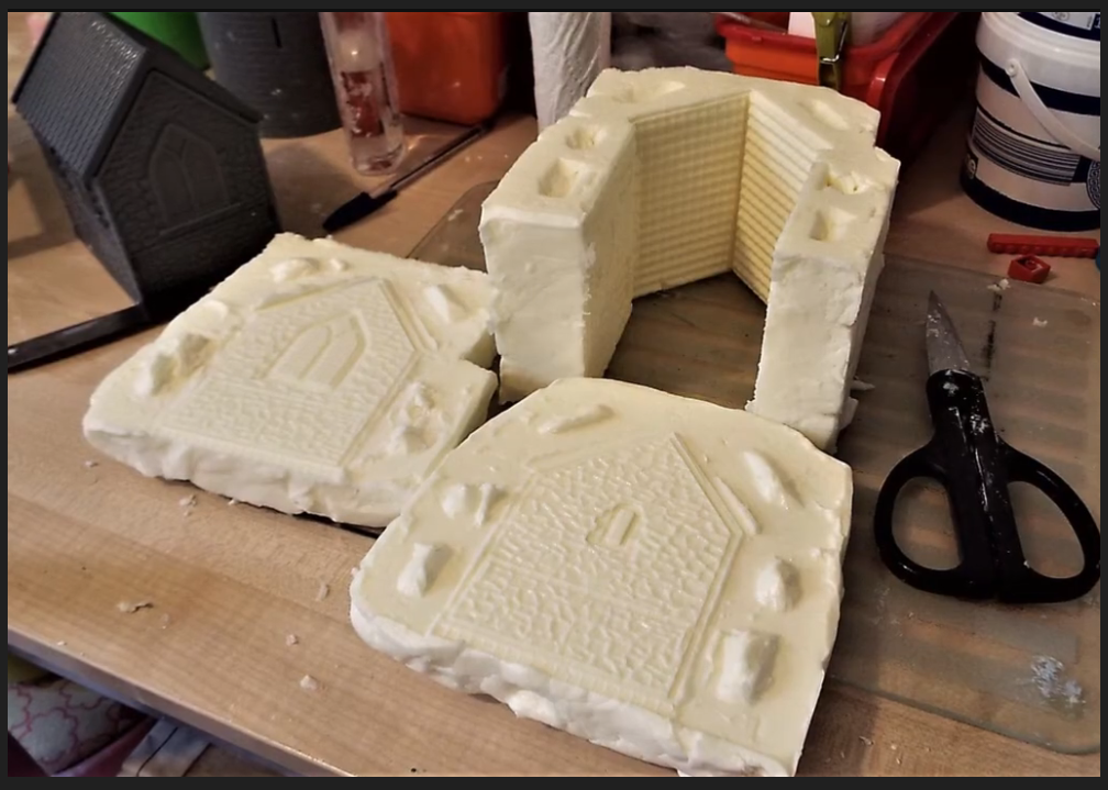

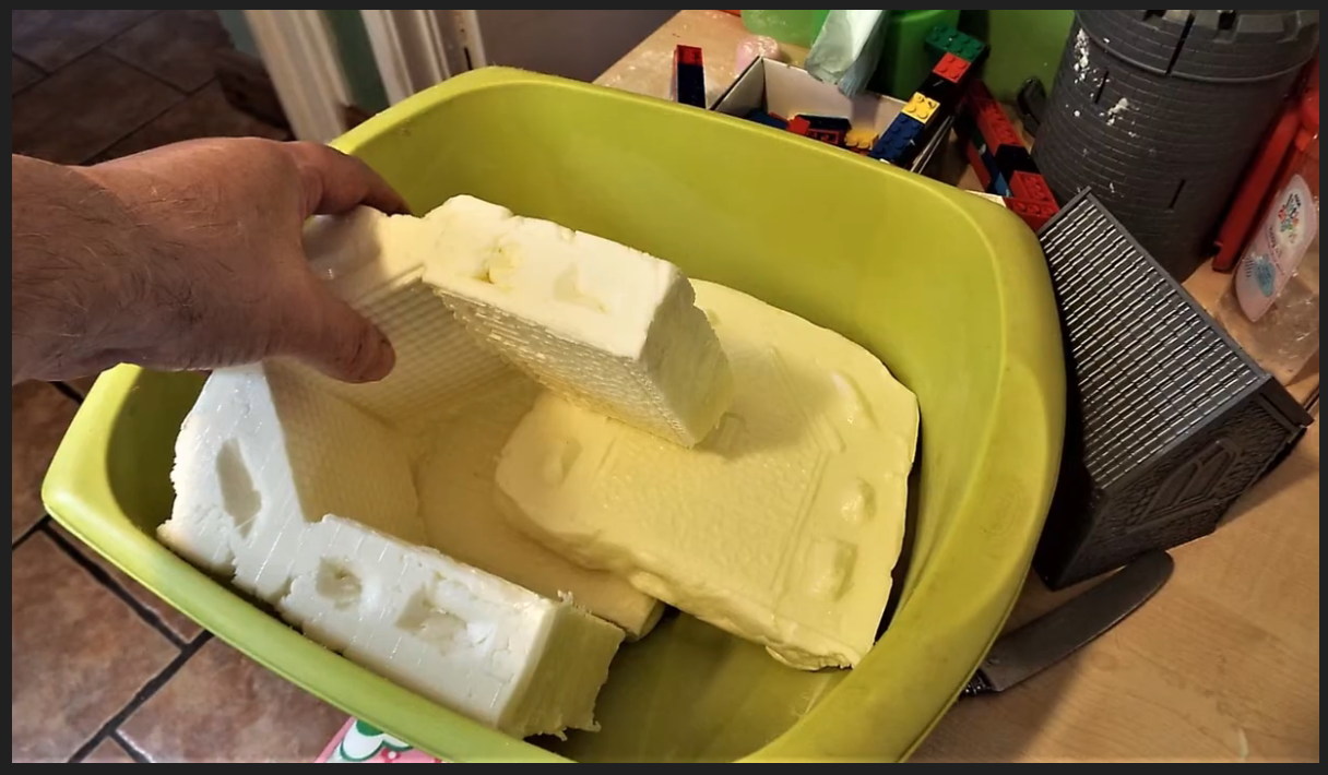

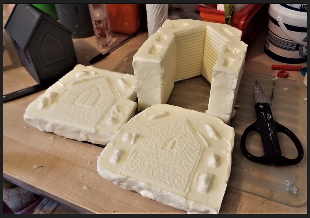

The end walls lay upon the table.
Now placed within my old washing up bowl they were ready for a hot bubble bath.
:coffee: A little later the mould was being put together to prepair it for casting up with resin. So i needed to pin the parts together.... Now then where did i put my collective stash of long hat pins?
:coffee: Ah, here are some holding tight the castle gate mould.

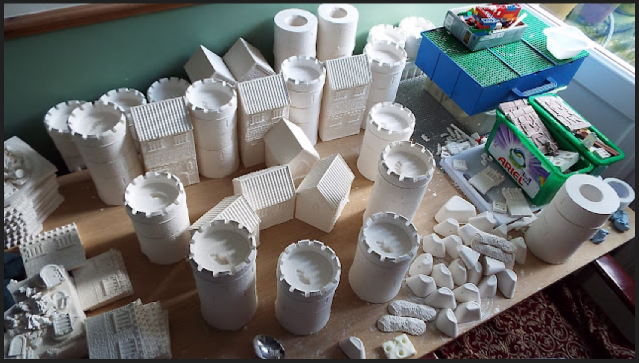

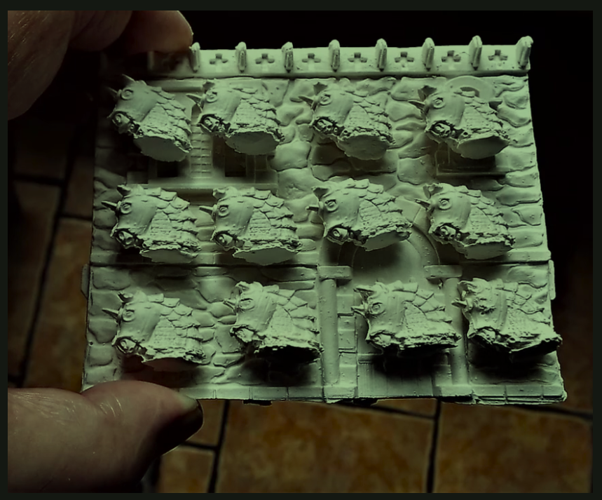

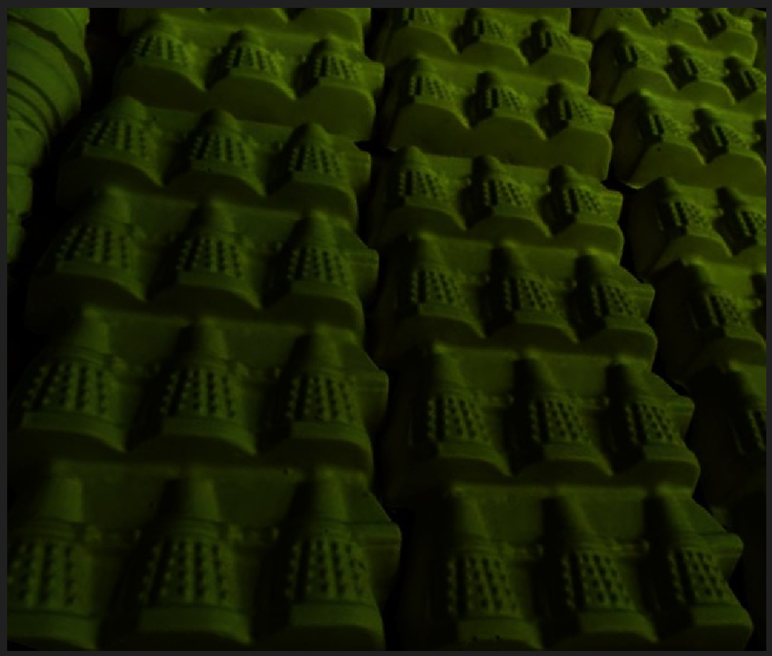

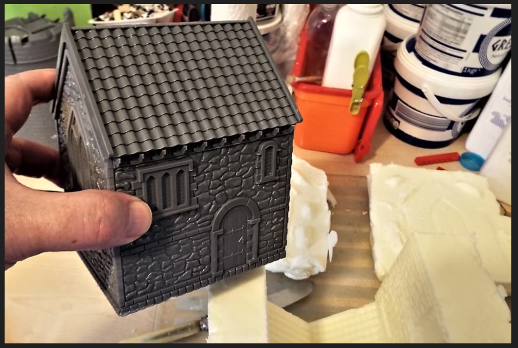

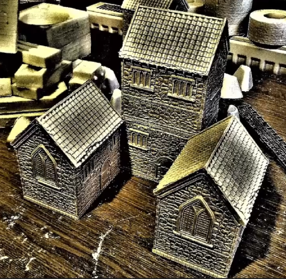

Within the heatwave of 2019 i toiled away my time upon my hobby and the internet. Here,the main thought was of casting a few up to stick upon the mighty walls of castles. An oddity of display using a dab of silicone to meet that final end.
Yes this sense of rendering up ones own gargoyles to direct the rainwater from medieval buildings was the main motive here. i soaked these in a thin colourwash of cold water within a large glass jar and they fizzed their way into turning to hardened stone. Five and a bit years on i still have them to display.

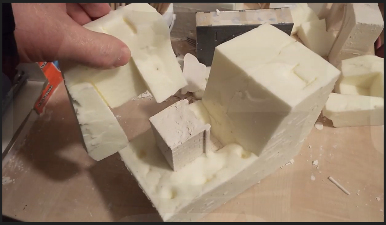

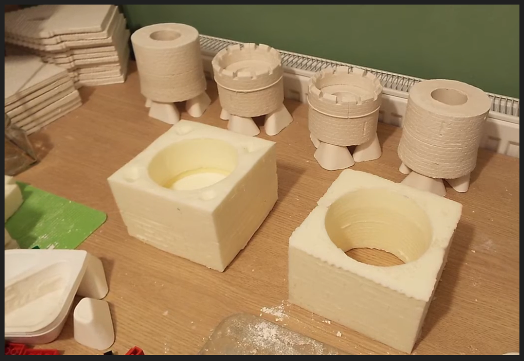

:coffee: Making another freestyle two part tower for my own use means 'not for sale.' The charm of having at times rather good cheerful days of hobbies,is certainly not my living,and it makes constructive time pass me by each day,and so there is no place for boredom. :eh: I'm never bored. :mrgreen: So what do you feel like today WingNut? :eh: Oh just fed up i supose. :mrgreen: There you go,i rest my case.

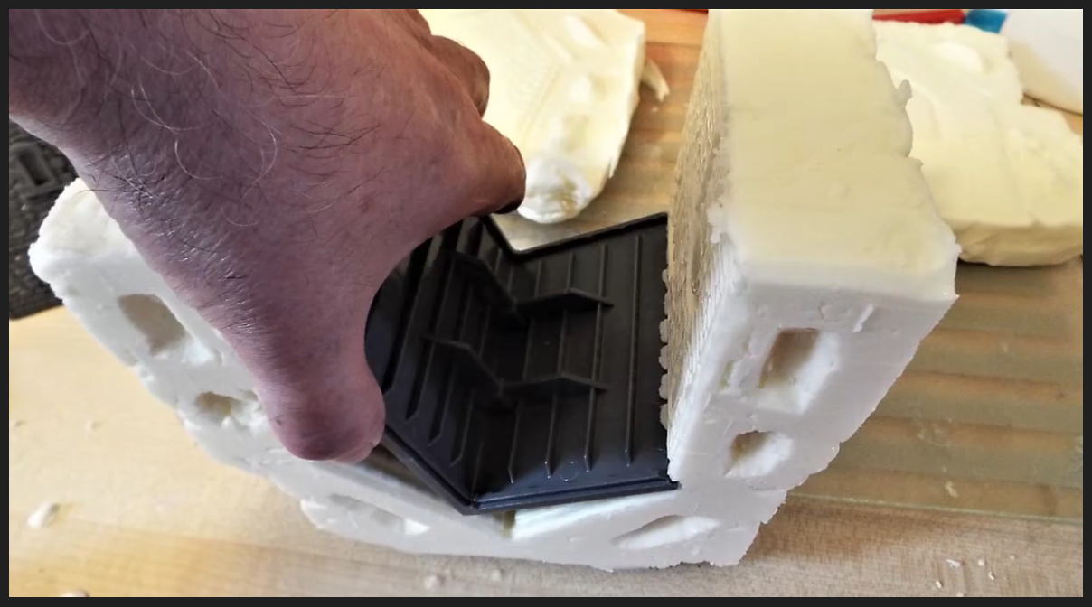

The pieces were easy to remove because i used baby oil as a parting flued.

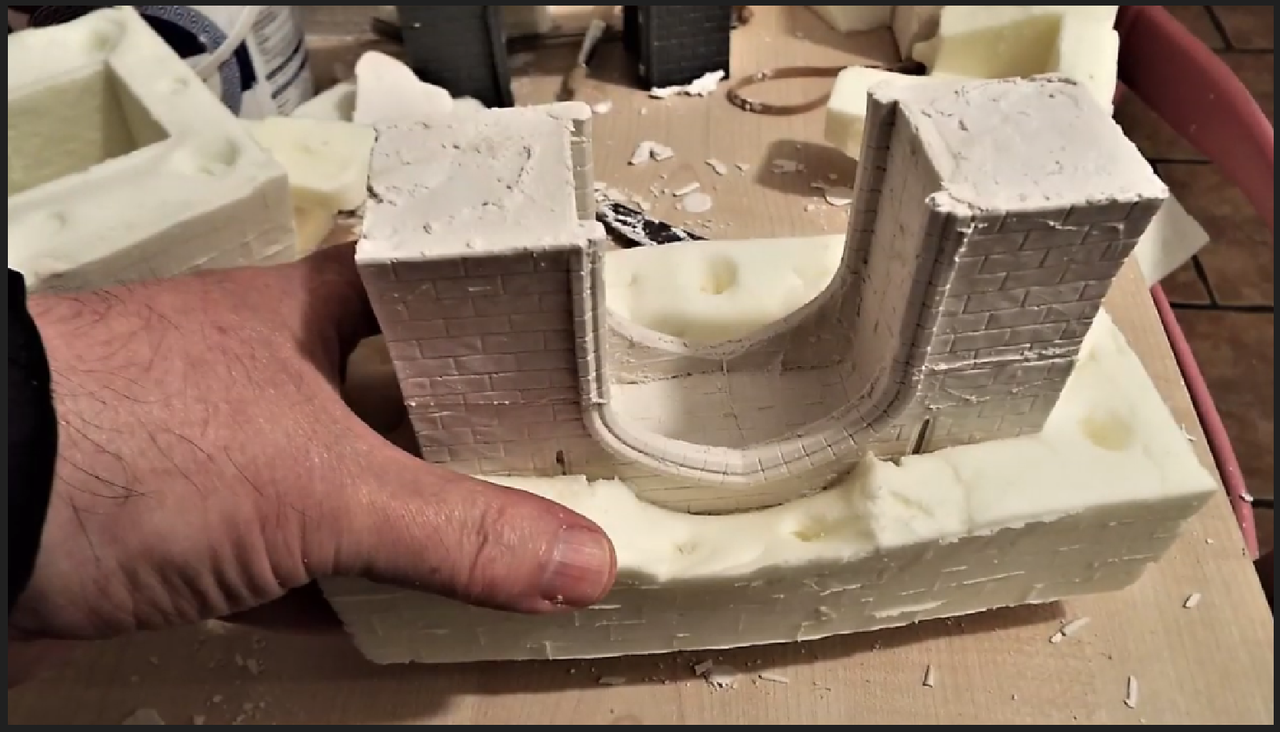

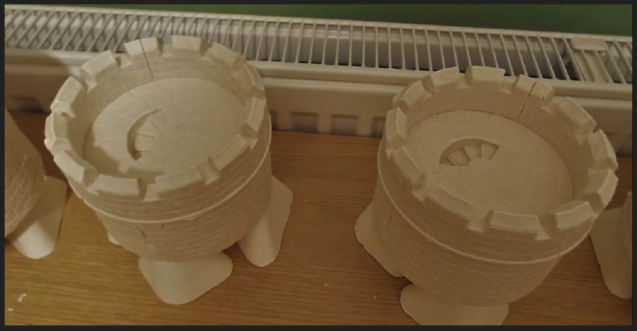

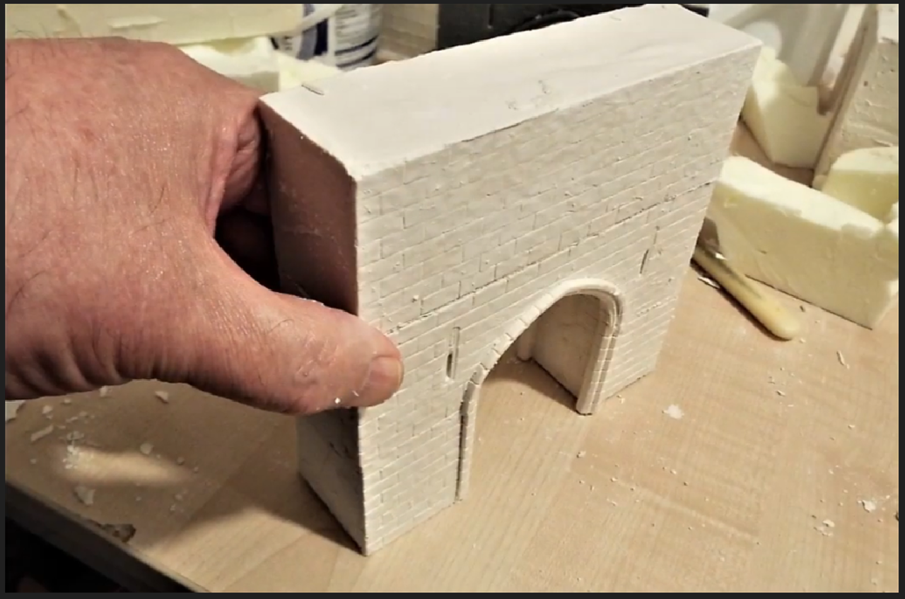

Two part round castellation moulds. By splitting this one up i could make up extra castings to increase the hight of their battlements!

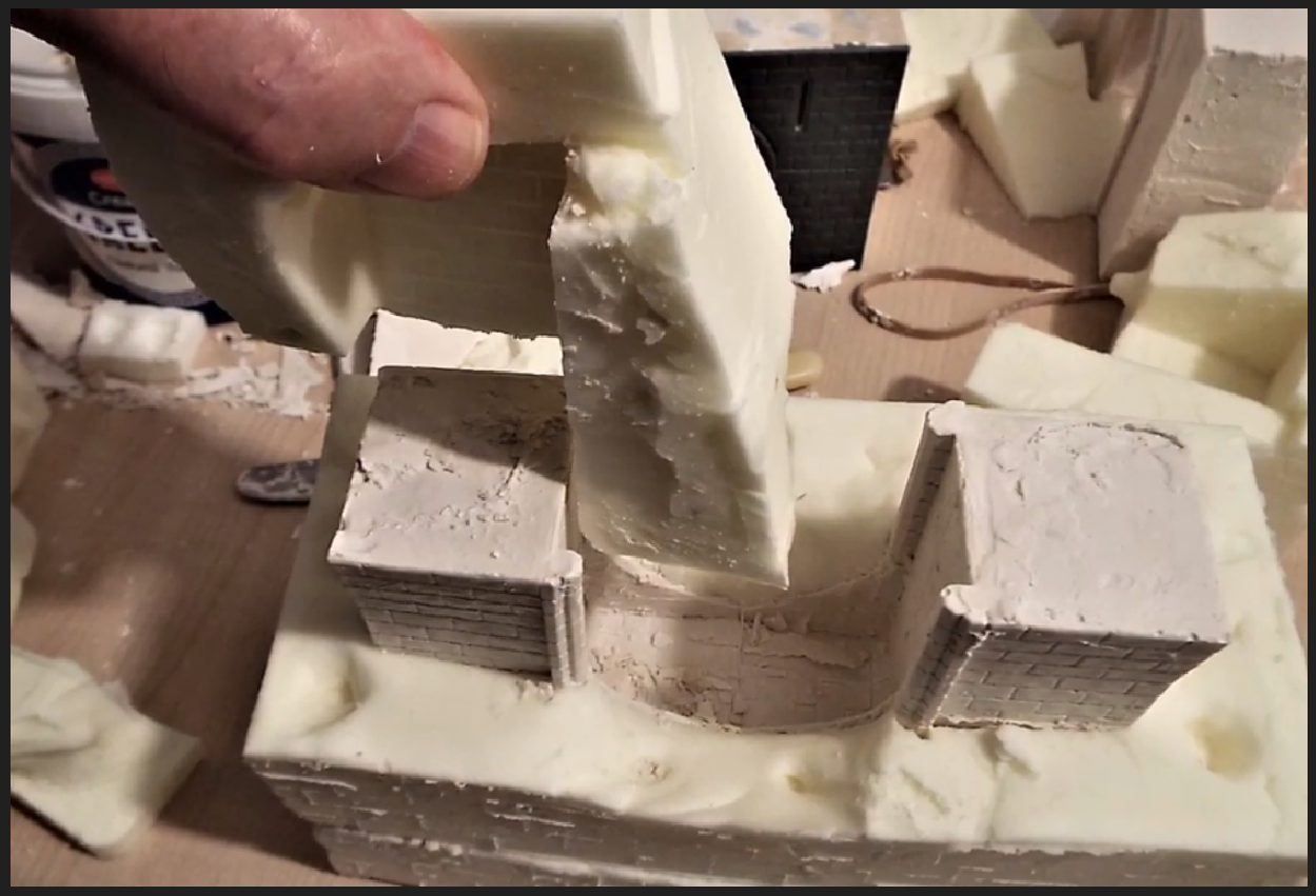

Another part was removed.
..... Raising the walls
The last piece was being removed .
:coffee: Castle Towers.... they sort of rolled out and fell up, :sst: rather than falling down,and rolling away', mentioned the little bright button. :mrgreen: that little fellow is so smart! Mr green said. :eh: i kinda wish i was. WingNut chimed in.
:coffee: The raised extension brought forwards will bring this defencesive gate to another level. All i have to do now is find the battlements topping.

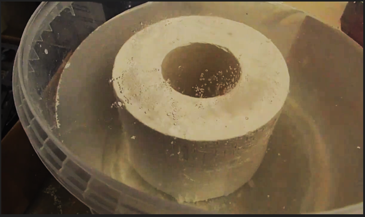

The cold water fizzing tub where this one hardened off to a stone like hardness certainly is worth placing here,because for myself it worked out fine and dandy. And this old picture of mine recently found upon You Tube,meant i could recover it along with lots of others that even though lost elsewhere they are now back within my own padlocked copyright pocket again.

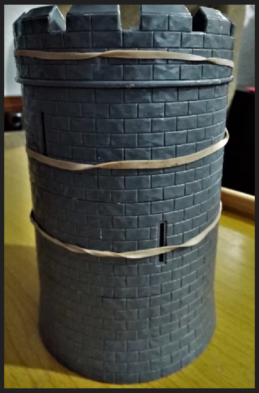

The plastic tower.
An object not completely stuck together i must confess,but the elastic bands serves a purpose to keep them all bound together in a likeness shape all who look at such a thing would identify with and what it is.
Looking at the parts that make up each stage of castle tower,i determined that each part i needed would be produced in their own seperate mould.
So the top castlelation upon its rounded wall, which can be viewed cast up above,and the lower section of wall that has a curve to it's bottem i would need to make in my own topsy turvy mathodical way.
Being able to produce loose castings i could pile up to new hieghts all my castle parts.

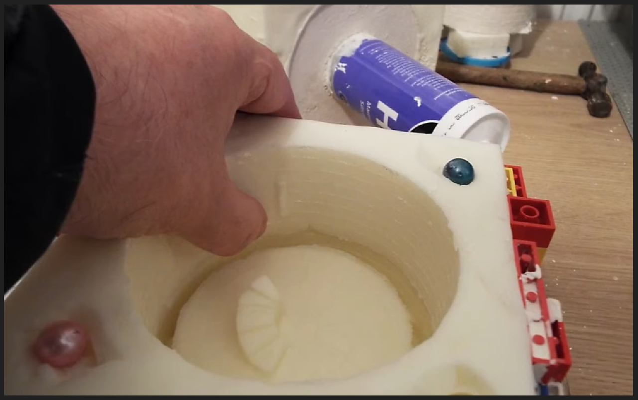

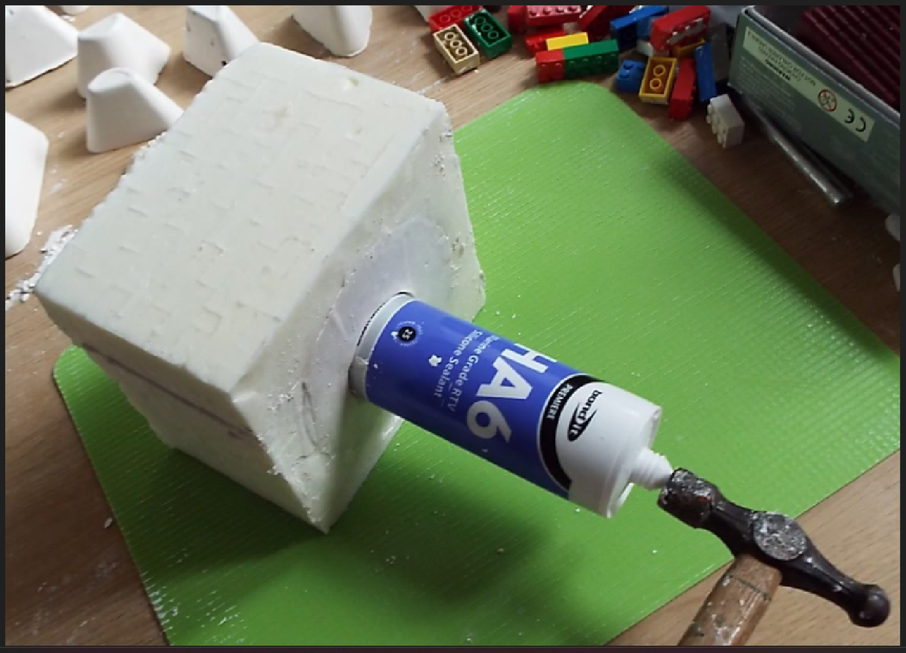

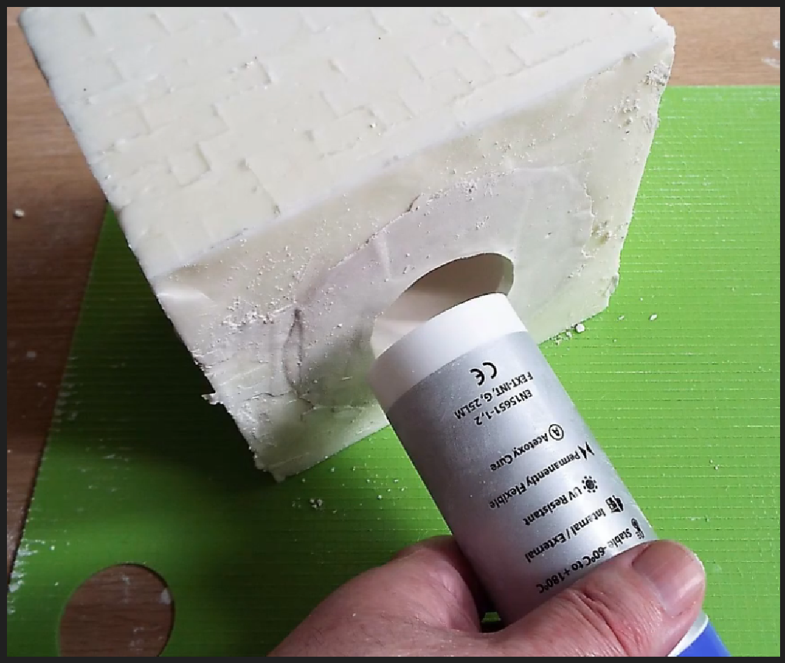

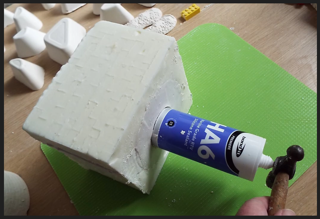

:coffee: A huge saving was to use the empty silicone cartradge to hollow out a few castings. All i had to do was stand the tube upright in the middle of the open top mould while i cast it up with my own free style uncomplacated mixed resin. :eh: Eh! Why? :coffee: Well after all it is a needful thing to do in order to save my pennies that when stacked up, eventually save me all those rather costly punched out under great pressure British Pound Coins.
ImageBonk! Bonk!Bonk!
:mrgreen: Of course one has to use a hammer to loosen the cartridge tube.
ImageBonk! Bonk! Bonk!
:eh: Eh! That's an awful huge size of hammer!
:sst: and so it eventually was removed,said the little button :cowboy: Well Pard's,this is interesting for an old time free granger like me. But i ain't very good with rather large sized hammerings myself. :eh: Eh! Always with the negitive! WingNut shouted out. It was at this point the well read Book Worn arrived upon the scene. :read: Entry into the ledger, a question... who would think it wise to let WingNut loose with a hammer? :mrgreen: Mr Green,could not resist asking, Who would let BB,loose with that hammer?
