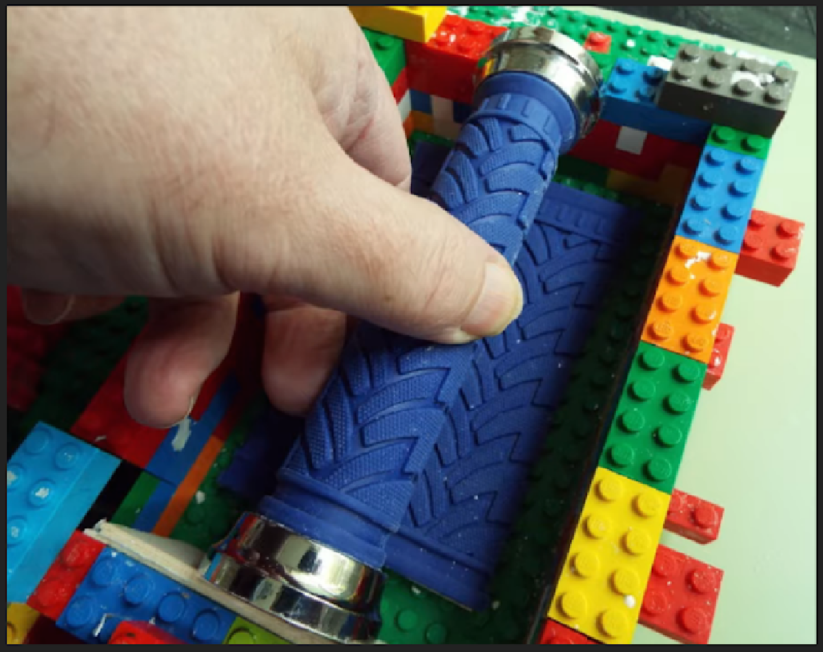

The Lego bricks were being collected after drying them,and this time a three part mould would be built up in stages. But a nice cup of tea arrived from the kitchen via my dear Mrs B, who smiled the smile of understanding as she looked at the work table with needful things piling up which were needed by my good self. Once again i would be employing the Chaos Theory again in my Quest to make a certain something. :mrgreen: Which is going to be such a mess!

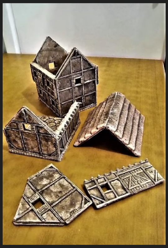

And so it was soon after slurping my tea,that the silicone was squeezed out upon the corn flour, it being starch that now needed baby oil added to it in order to help blend a good mix for another moulding adventure to begin. Baby oil is not cheap,and cooking oil is cheaper. However that can also be used,but there is a lot of sugar in cooking oil and it will seap out of any mould and make them very sticky indeed. Yes i know this to my cost.
This building would be the cheap Pattern and passage leading to somewhere else.
This turned out to be a three part rubber mould.
The guidence pegs will fit snugly together settling into their guidence holes which means that there is only one way to put it all together ready for pouring my resin into it. i went forwards by using very long hat pins to reconstruct every mould which were fixed tight inspite of pouring my resin mixture into them.

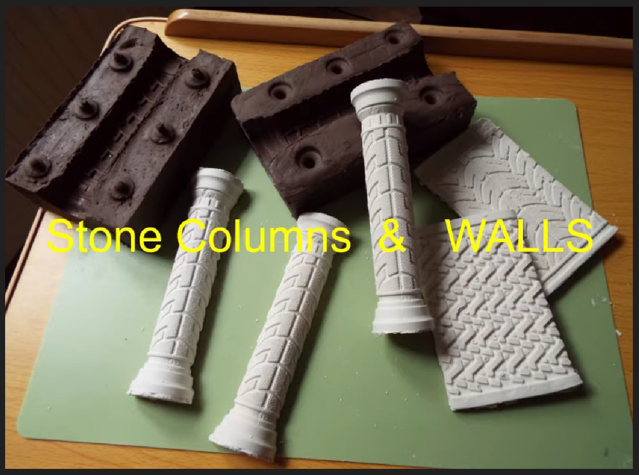

These are my newest plastic bricks,and some of these formed the multi part moulding box.
The mould being four sides and the top way down in the bottem,and i must admite it did look rather odd with long sized hat pins holding everything in place.
The very long sharp pointed pins that held everything together were removed ...
And the loose roof pattern remained in the bottem which was as i planed.
So removal of the four sided pattern took place.
Often is the case within industry loose pattern pieces are designed and used to avoid damage to the mould as the main pattern is removed.
i desided as the roof overhangs this structure, it would become a loose pattern.
So with a little flexing it was removed safely without ripping the silicone.
The end walls lay upon the table.
Now placed within my old washing up bowl they were ready for a hot bubble bath.
:coffee: A little later the mould was being put together to prepair it for casting up with resin. So i needed to pin the parts together.... Now then where did i put my collective stash of long hat pins?
:coffee: Ah, here are some holding tight the castle gate mould.

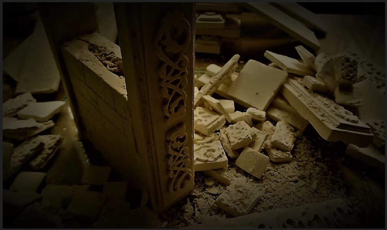

Yes this sense of rendering up ones own gargoyles to direct the rainwater from medieval buildings was the main motive here. i soaked these in a thin colourwash of cold water within a large glass jar and they fizzed their way into turning to hardened stone. Five and a bit years on i still have them to display.

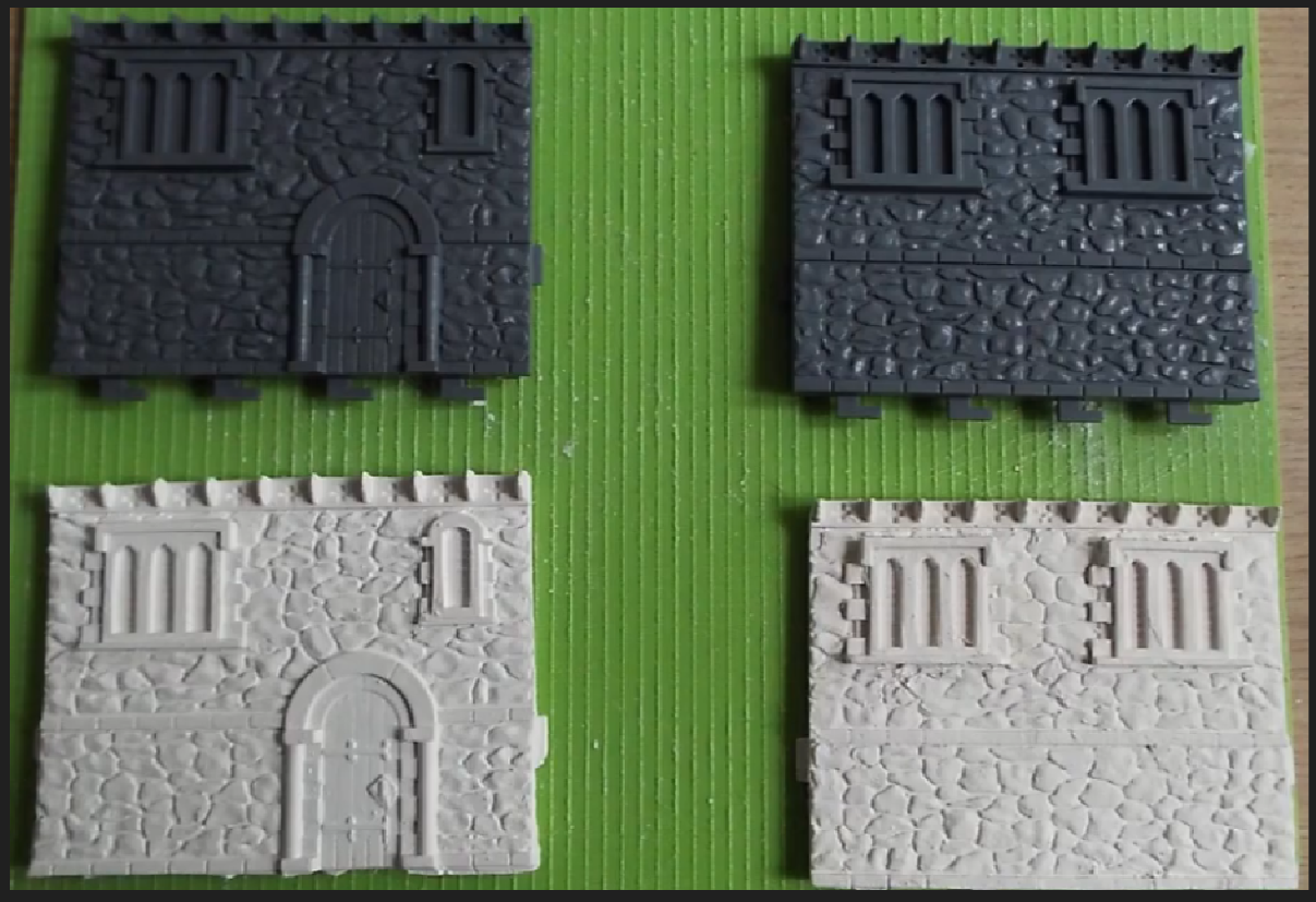

:coffee: Let's do that than. Some of the plastic pieces i used to make patterns worthy of the cost of my silicone moulding lay scattered below.
:coffee: Below,the first piece having been removed shows nothing much,however as the others are removed the casting will be revealed on this ongoing display.
... :mrgreen: So here we go again. :sst: just toddle along within this topsy turvy topic. The little button,advised.
:coffee: Making another freestyle two part tower for my own use means 'not for sale.' The charm of having at times rather good cheerful days of hobbies,is certainly not my living,and it makes constructive time pass me by each day,and so there is no place for boredom. :eh: I'm never bored. :mrgreen: So what do you feel like today WingNut? :eh: Oh just fed up i supose. :mrgreen: There you go,i rest my case.
The pieces were easy to remove because i used baby oil as a parting flued.
Two part round castellation moulds. By splitting this one up i could make up extra castings to increase the hight of their battlements!
Another part was removed.
..... Raising the walls
The last piece was being removed .
:coffee: Castle Towers.... they sort of rolled out and fell up, :sst: rather than falling down,and rolling away', mentioned the little bright button. :mrgreen: that little fellow is so smart! Mr green said. :eh: i kinda wish i was. WingNut chimed in.
:coffee: The raised extension brought forwards will bring this defencesive gate to another level. All i have to do now is find the battlements topping.
The cold water fizzing tub where this one hardened off to a stone like hardness certainly is worth placing here,because for myself it worked out fine and dandy. And this old picture of mine recently found upon You Tube,meant i could recover it along with lots of others that even though lost elsewhere they are now back within my own padlocked copyright pocket again.
The plastic tower.
An object not completely stuck together i must confess,but the elastic bands serves a purpose to keep them all bound together in a likeness shape all who look at such a thing would identify with and what it is.
Looking at the parts that make up each stage of castle tower,i determined that each part i needed would be produced in their own seperate mould.
So the top castlelation upon its rounded wall, which can be viewed cast up above,and the lower section of wall that has a curve to it's bottem i would need to make in my own topsy turvy mathodical way.
Being able to produce loose castings i could pile up to new hieghts all my castle parts.

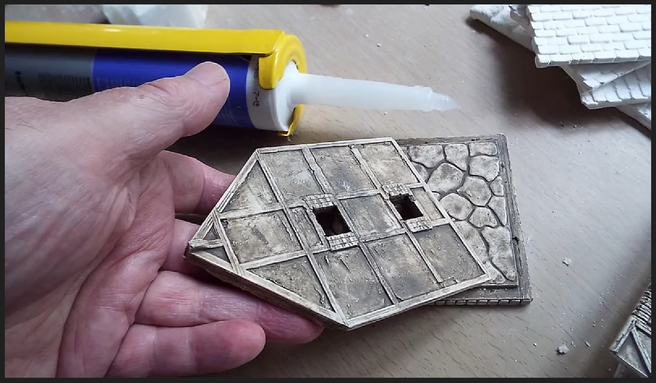

:coffee: A huge saving was to use the empty silicone cartradge to hollow out a few castings. All i had to do was stand the tube upright in the middle of the open top mould while i cast it up with my own free style uncomplacated mixed resin. :eh: Eh! Why? :coffee: Well after all it is a needful thing to do in order to save my pennies that when stacked up, eventually save me all those rather costly punched out under great pressure British Pound Coins.
ImageBonk! Bonk!Bonk!
:mrgreen: Of course one has to use a hammer to loosen the cartridge tube.
ImageBonk! Bonk! Bonk!

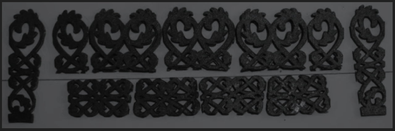

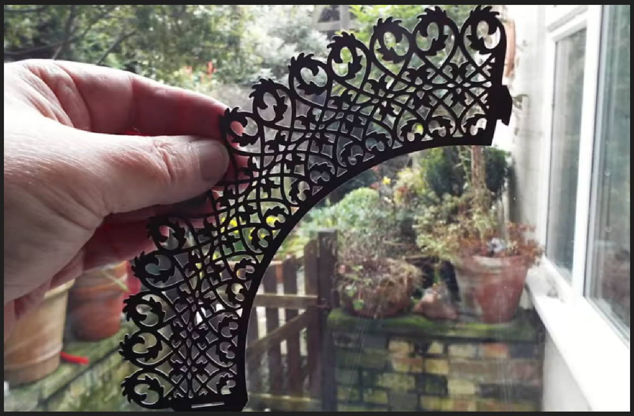

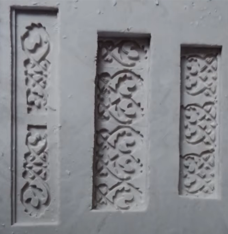

:coffee: i came upon these in a round about way many years ago, :mrgreen: And BB,thought 'i can use these.' :eh: But what are they? WingNut asked. :sst: they are for forming a presentation around cup cakes. replied the little button. :eh: What's a cup cake? WingNut murmured out rather quiet-like for he certainly had no clue what it was for.Although he knew what a cake ought to be.
:cowboy: Dang fancy like little things ta dress up a cake, if'en ya ask me. Chimed in the Cowboy,who had had no time for such things since hitting the cow punching, pushing trail,for a Dollar a day.
:coffee: Ah! Such dusty trail Boss days were had by those trusting in gain along with the pain.
:coffee: And so it was that some of the cup cake shapes were cut off the sprue... :read: Yes let's call it that,shall we? Asked the well read Bookworm. :mrgreen: Oh! What a spree we can have with a sprue! :eh: Eh! I don't know what you mean? WingNut muttered.
:sst: well it is simple to cut out patterns in order to make one. The little button explained. :eh: Eh! You mean cut out lots of them to make one?
:coffee: Yes that is correct,said BB,although i'll have to see how each one turns out..... :mrgreen: Mr Green, declared it just to mean BB's Quality and Control.
:beer: I'll drink to that, Ecin Reebs Hoo-rah'ed as he raised a beer. :eh: I made mention of it before,that there ain't no money in it, but where did you get that cool one? WingNut, curiously asked. :coffee: It does seem that there is more going on here,that does not meet the average eye. :mrgreen: I'mmm,is someone playing favourites here. :coffee: Certainly not replied BB.
:coffee: Two oblong strips of paper card were indeed of play, cut out and stuck together with waterproof PVA Glue and all those odd shapes were glued into place upon each one. These were the Patterns that made it possible to mould each and every shape in silicone.
:mrgreen: These open top silicone moulds might give you an illusion that they are solid filled,but of course they are not. :coffee: But you can keep your eyes upon them in order to see what is not there.... :sst: if you like.

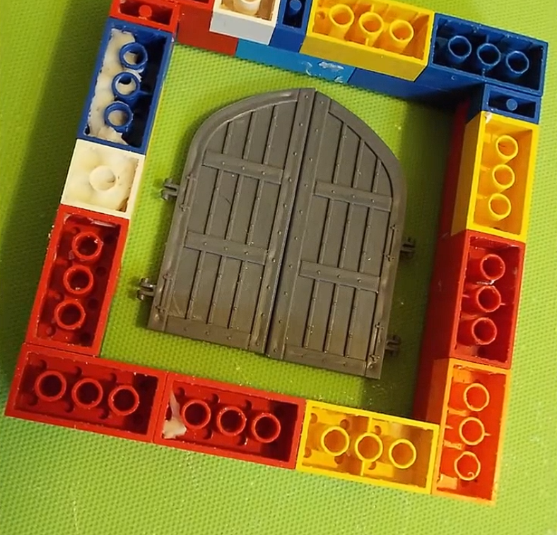

i had already used the ace cool Lego bricks to form the moulding box, soon it was rammed up with the top row patterns well tucked up within it, Much later after casting them up i determined that those bottom plastic clips should have been cut off, because they were a difficulty that i ill deserved. Used as patterns only i should have had enough sense to remove them in the first place. So there it was that i learnt a lessen the hard way.

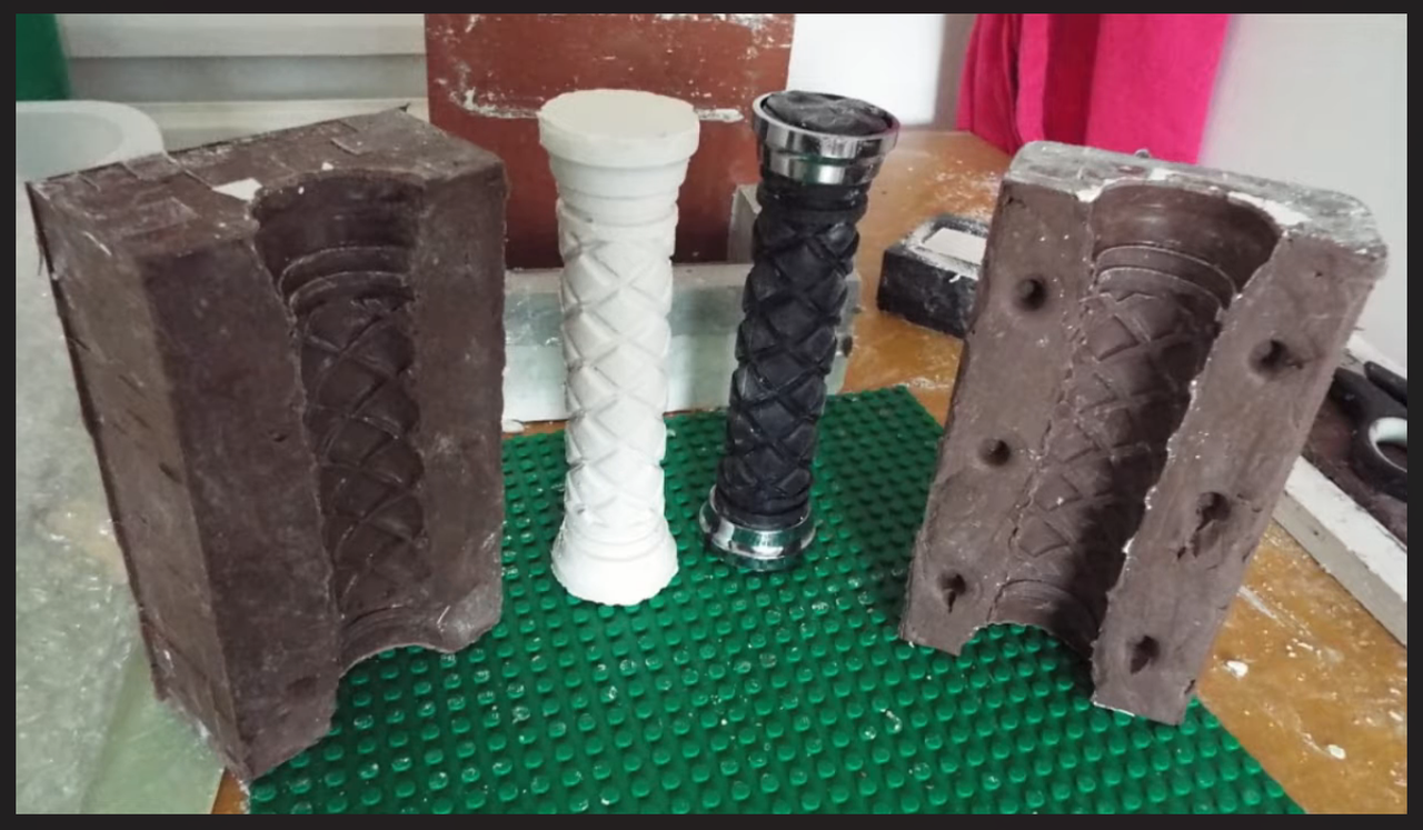

This moulding box with reusable bricks was filled with my silicone mixture and the end result i was very pleased with.
The mould of the gateway double door's to my twin castle towers, were upon my list years ago,and these were needed for other multiple archways too.

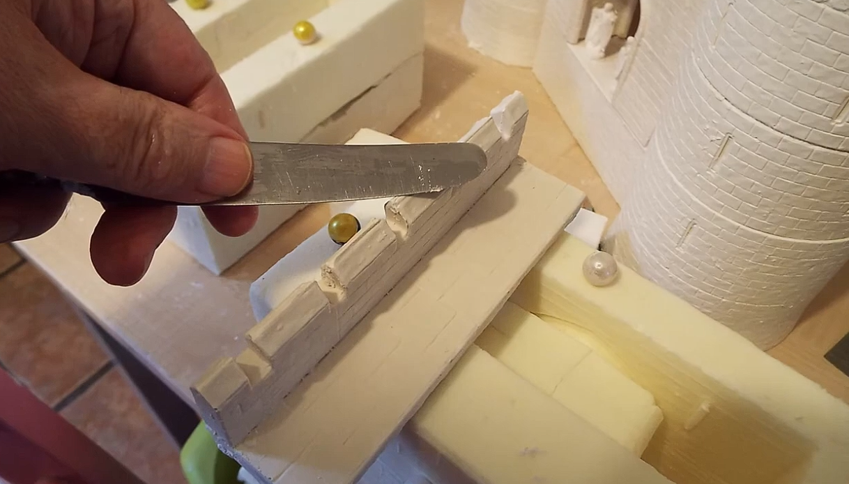

Getting back to this one below.
The top castlelations once removed being still damp could be smoothed over with my trusty state of art butter knife if tiny areas needed it. But with the silicone mould being very durable i could cast 50,100 or more if i saw a great need for me to do so,but of course i don't. i just wanted to explain how hardwearing these trusty fellows were, OK ?

:coffee: There is a base and two end walls followed by two side walls and they will be capped off with two slooping rooftop casting.
So these little dwellings are both seven part buildings which also require extra silicone to construct them. :eh: You mean they will be hollow inside? Asked WingNut. :eh: Eh! i did? Yes i did. :coffee: i don't believe it. :eh: Me anall!
:coffee: Which is swings and round abouts when the price of casting up materials and silicone is fully considered. But i soldier on because i need to swell and widen out... as indeed of playing well we all ought to do. :sst: so the greater savings will be on the casting up powder? Asked the little button that only speaks in lower class letters. :mrgreen: Yip! That's right!
:coffee: Count and keep your pennies when you recieve the change,because eventually they will turn upon their rise , into lovely golden British Pounds. :read: Which is of the highest value in the whole wide earth of free range trading.
:coffee: And topping off other rising castings appear upon this expanding topsy turvy pathway of expanding energy! :eh: But where are the moulds BB? :mrgreen: BB, lost them. :eh: Eh! What?
:coffee: Yes that is so,but one must consider they were made in that rather hot summer of 2019 before this world was pushed beyond reason upside down! :sst: so welcome since then to topsy turvy lands. :coffee: Living it is believing it reasoned the Orange King of the South, as his gold bullion flowed into oily hands. :mrgreen: And the other Great King from the ice cold bleak North born from the Cyclopes agreed that he would have some of that gold bullion too. :eh: So what of the other kings than? WingNut asked. :cowboy: You mean those from the West and the East Pard? Asked the cowboy who was getting ready to ride the whirlwind again. :affraid: And now the King from the east wanted just to trade as if trading from the other three quarters of the world had not changed.
So there above are the ornate columns and walls. Remember when the column mould was close and fix tight with hat pins?
Well each flat outside part showed the impressions of the flat walls. So this silicone mixed with cornflower and baby oil produced three typs of castings because i utilised the outside space in order to gain what i see as free mould producing area's that cost me not an extra penny or a rather expensive English Pound!
:coffee: Not to expensive creating this by using other handle bar handles. Looking around i find and see the potential of other things that are so cheap and everywhere!

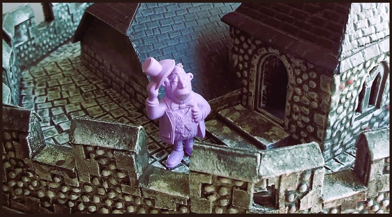

The scene was set with an ancient stone work ruin the likes of that Sir Percy the descoverer of strange new worlds had never ever seen before.and it did seem to be flooded out from a heavy downfall of water.
