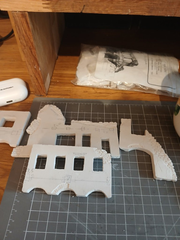

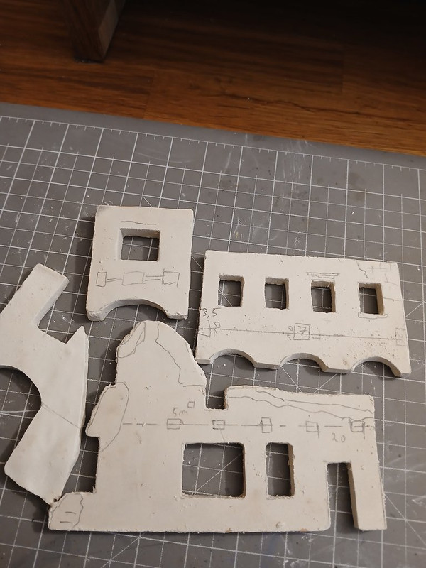

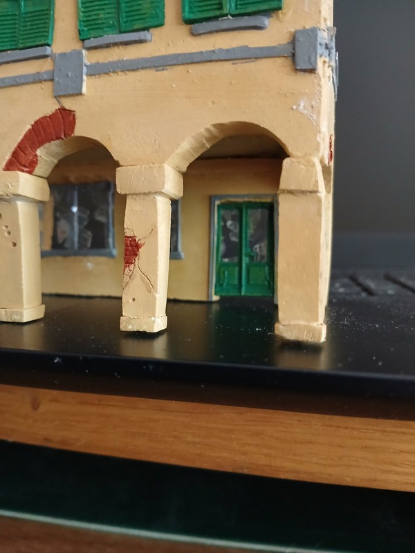

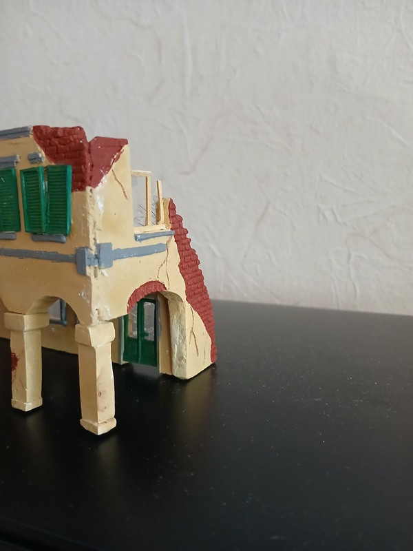

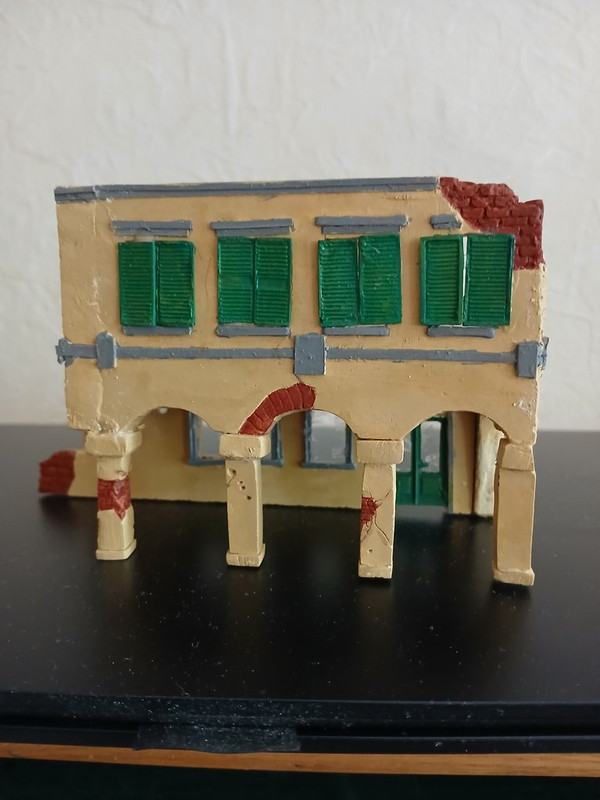

I need a house. I used a Vaku kit from my collection as a template.

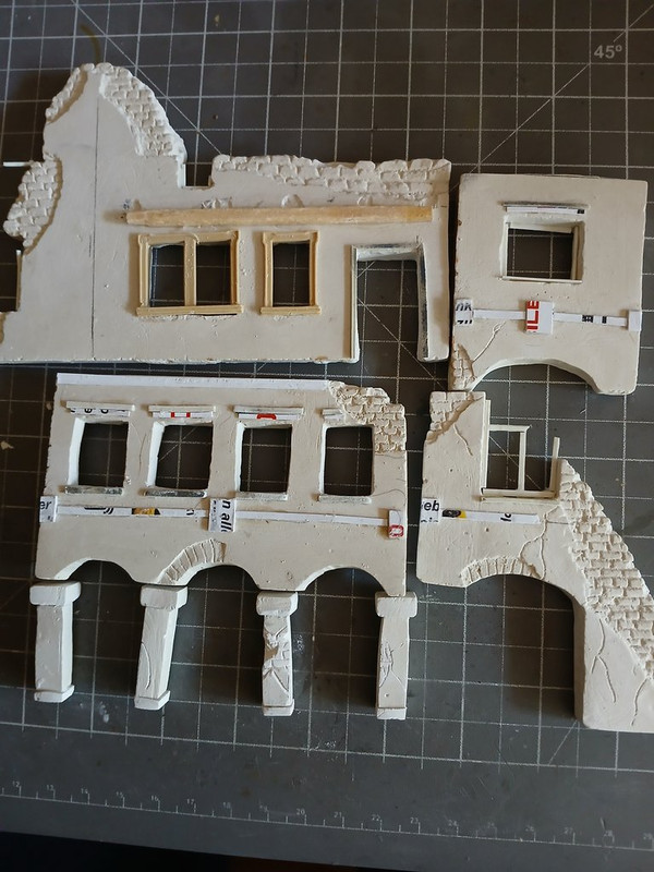

Since the Vaku kits consist of two halves that rarely fit together nicely, I decided to build the house out of plasterboard.

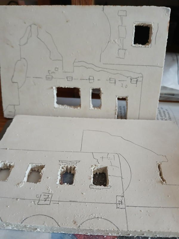

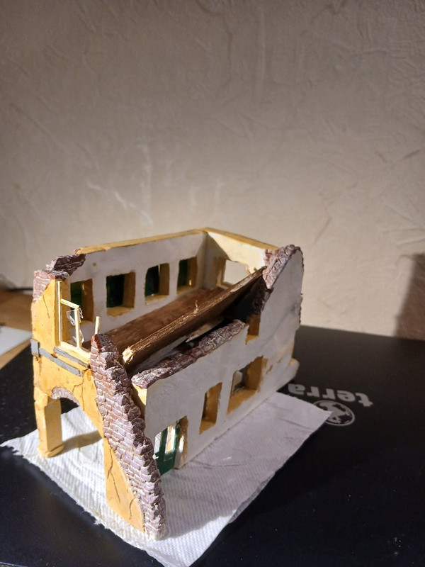

First, I needed plasterboard. I stuck sticks from Sylvester rockets tightly onto a smooth board with tape, filled it with plaster, and it was done. After it dried, I traced the outlines and cut it roughly to size. I engraved the brickwork and drilled out the windows and doors.

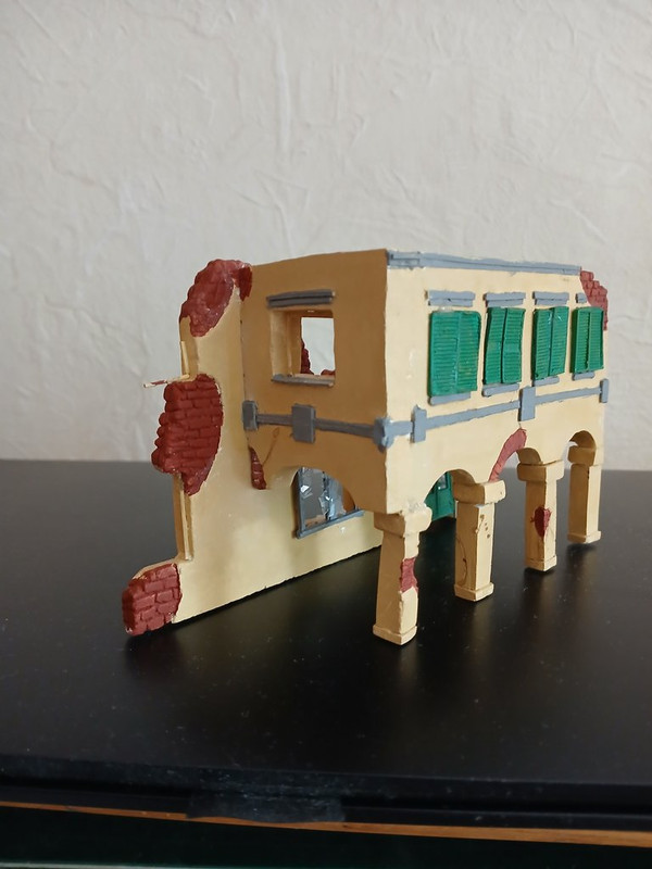

So, hole by hole, as if perforated (see photo no. 1), then milled through the webs and filed the window dimensions correctly. Adding water from a pipette reduces the risk of breakage. Nothing broke for me. Window frames can be used from the railroad accessories. Pay attention to the window dimensions. The decorations are simply cut from plastic sheet and glued on, as are the window sills and the destroyed window frames.

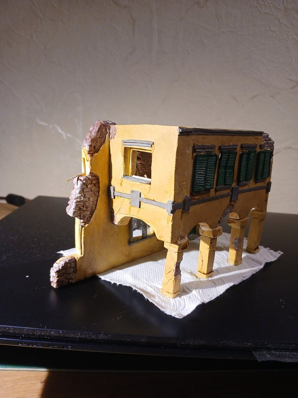

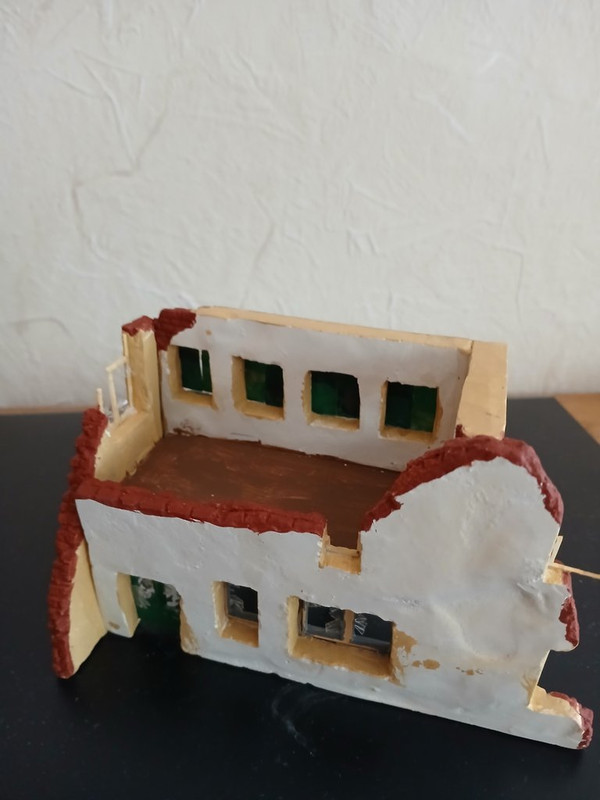

It is important that after all engraving work, the house is treated with “Maler Tiefengrund” (painter's deep primer), which is a mixture that makes it easier to remove wallpaper. In Germany, it is also known as Makulatur.

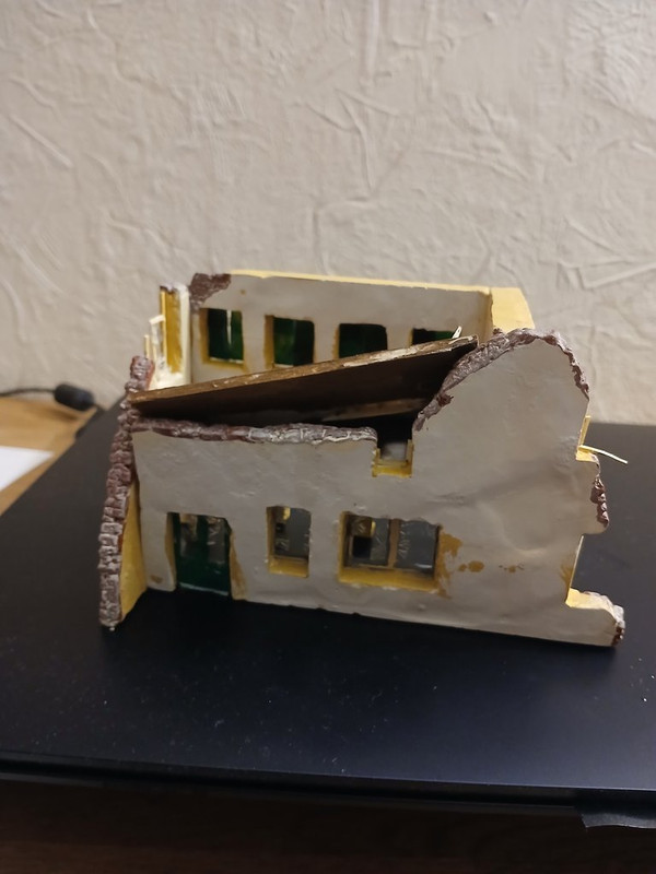

It ensures that the substrate is not so absorbent. You would need a lot of paint. The collapsed roof is made from an orange crate.
The green window covers are casts I made from master models. They are made from plates from the railway sector. Smaller scale than H0 /1 /87.
That's it for now on house building. If you have any questions, I'll be happy to answer them.

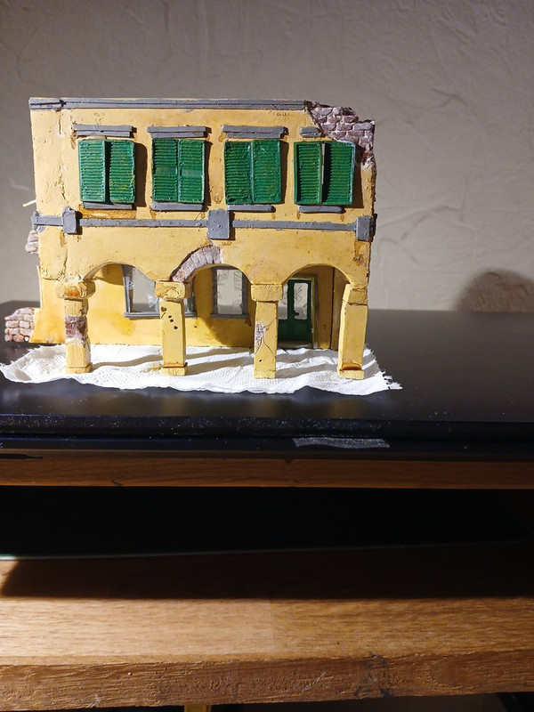

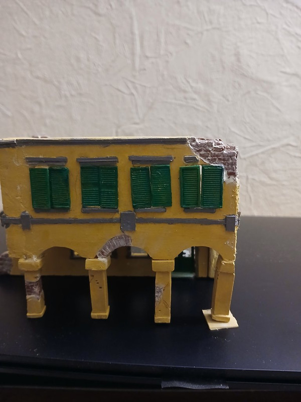

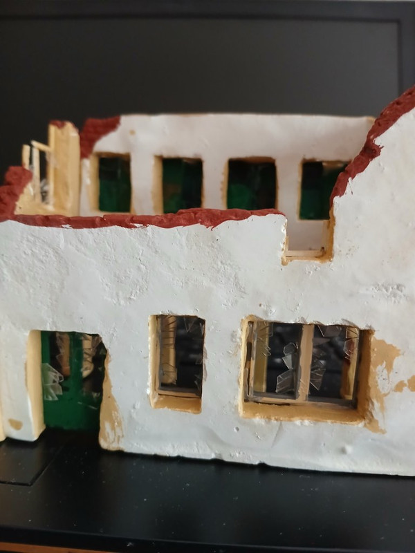

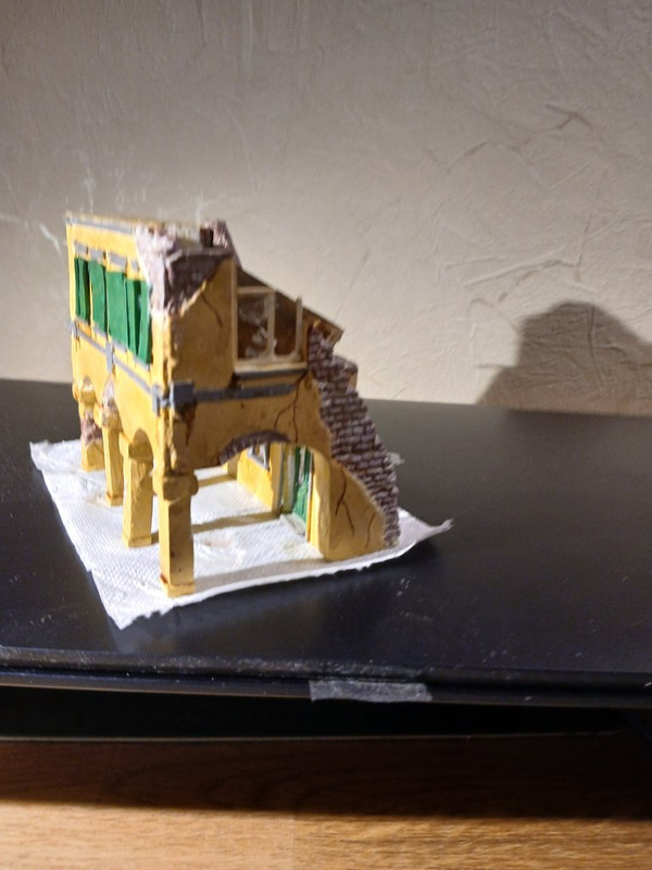

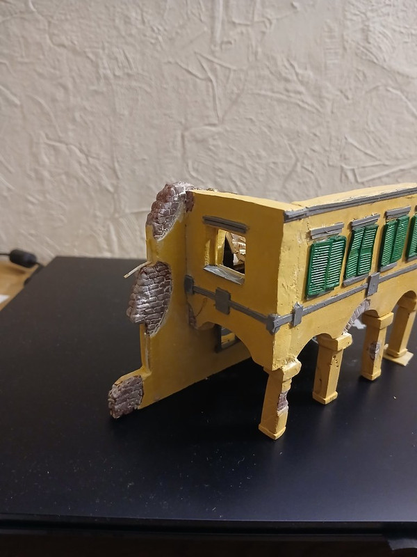

Here are a few more pictures with different lighting.

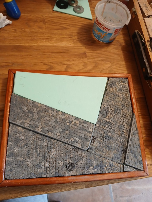

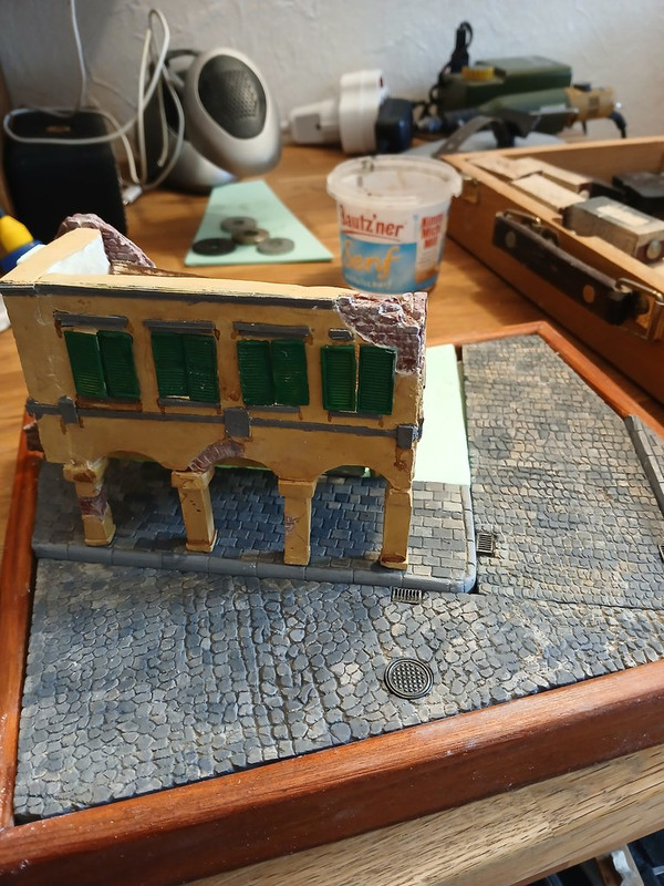

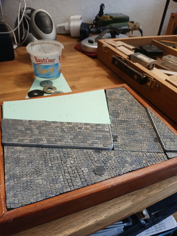

The base for the diorama is 25x18 cm. The roads and sidewalks are all carved out of plasterboard. Everything is glued in place, including the drains, etc. The only thing missing is the background of the house. That's where the crew of the Puma is supposed to run away. Does anyone have any ideas on how I can make this look realistic?

Where is the dio situated? It looks like somewhere in the south?
Posted by Michael Robert on 28 Sep 2025, 14:33
Hi Jürgen,
very nice of you to show how you make the house. Plaster technique, very interesting and beautiful result. I have learned in M Cryns' workshop the foam sculpting technique. Also very helpful. I think the two techniques are quite complementary.
Anyway, your result is great. I can see the effort and craftsmanship.
Jan, the ruined building look exactly like buildings in the North of Italy (south of you :-)). Towns like Colorno (remember Don Camillo?), Boretto and Castelnuovo di Sotto.
Waiting for final result, but WIP is maybe better
Posts: 914
Posted by JurgenH on 28 Sep 2025, 15:46
I'm glad you like my plaster casts. I'll be happy when the mess on my desk is finally cleared up.
No, that's completely wrong. It's coming to Germany, in the last days of the war. It just depends on a few appropriate signs. That's why the Puma is so battered. I've clarified the story behind it.

I've done some extensive work on the base. Tonight, I finished working on the base. I still have to compile the pictures and text. As soon as I'm done, I'll post the article.

Here are the pictures of the finished house. First, I would like to show you the pictures of the other house I built several years ago. The diorama is supposed to depict an advance
