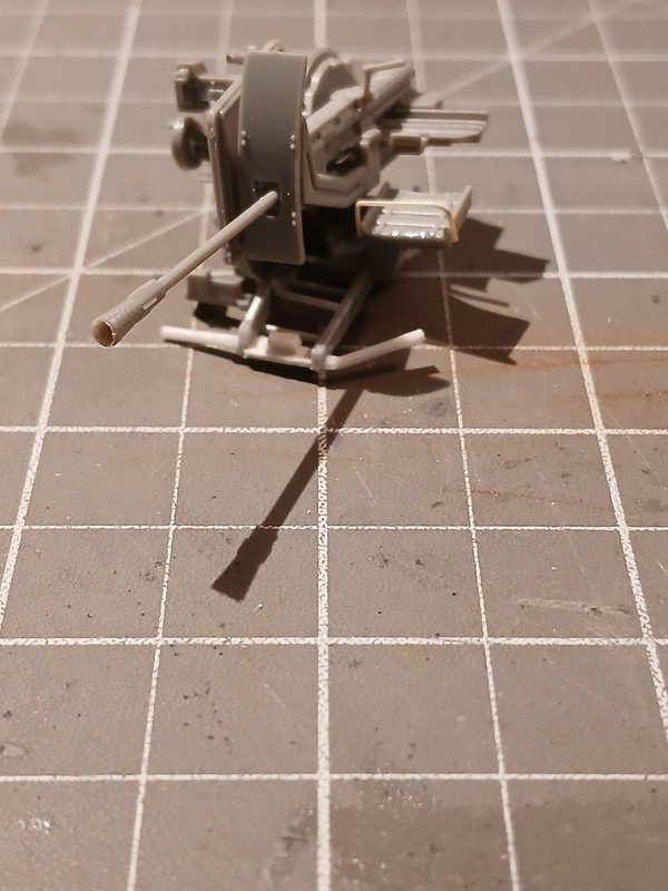

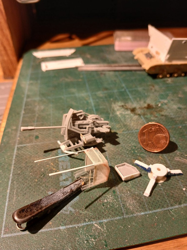

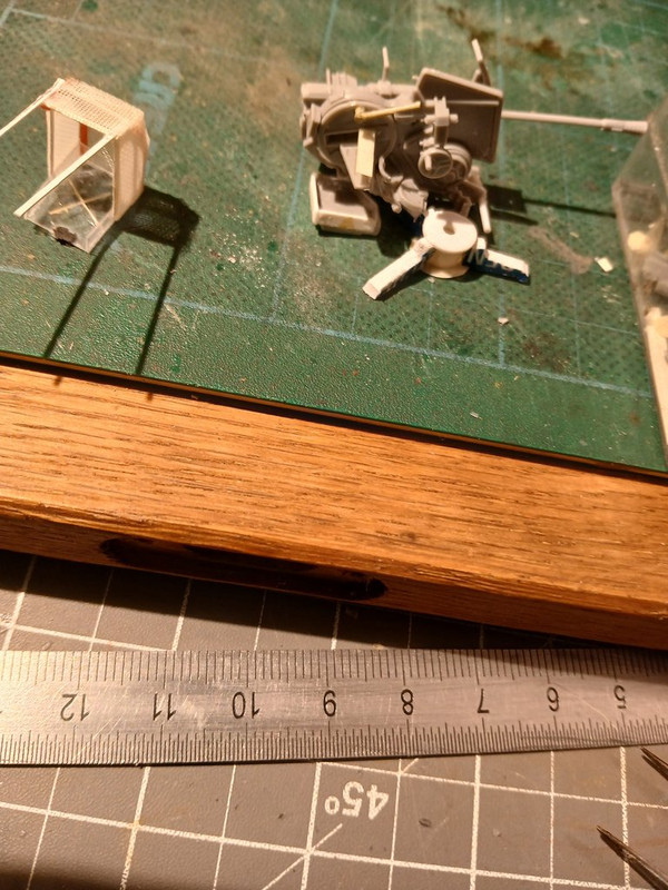

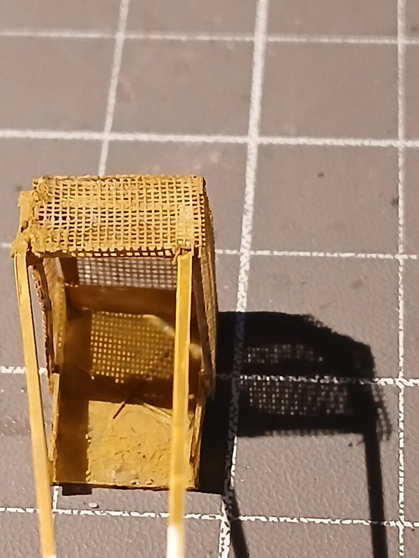

Posted by JurgenH on 22 May 2025, 11:12
Hello, i think it is time for a littel Update from my Möbelwagen.

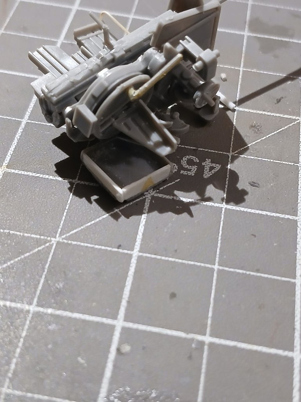

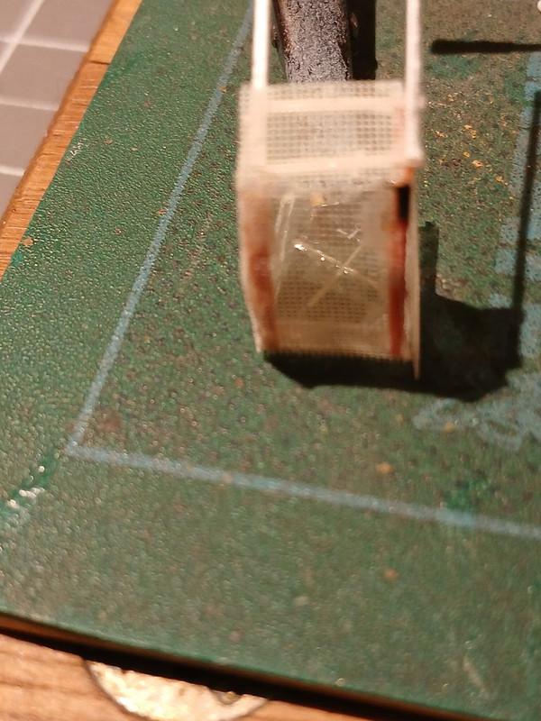

Now it's time for the flak itself. The 3.7cm Flak 43 is taken from the Panzer II Ostwind kit. Since it is the stripped down version of the Ostwind, many parts were not available or were reproduced in minimized form. All parts that are not from the gray plastic of the kit, I have added. Including the base for the shell catcher, which I modified. Which of course was once again incorrectly designed by Revell. I then built a completely new basket from plastic strips and curtain fabric and painted it. Afterwards it is no longer so good for painting. The new part is next to the kit part with the white edge.
Best wishes at all.

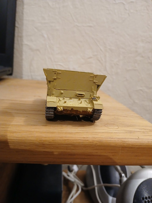

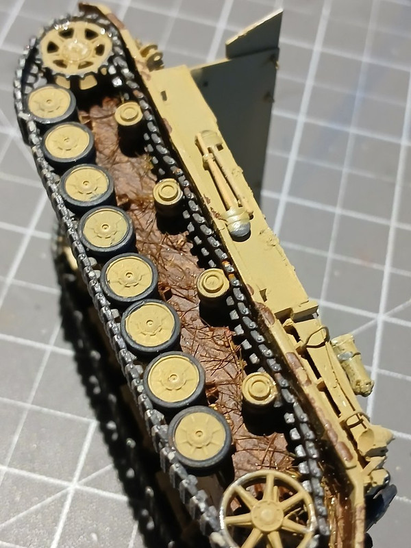

Posted by JurgenH on 01 Jun 2025, 19:04
Hello

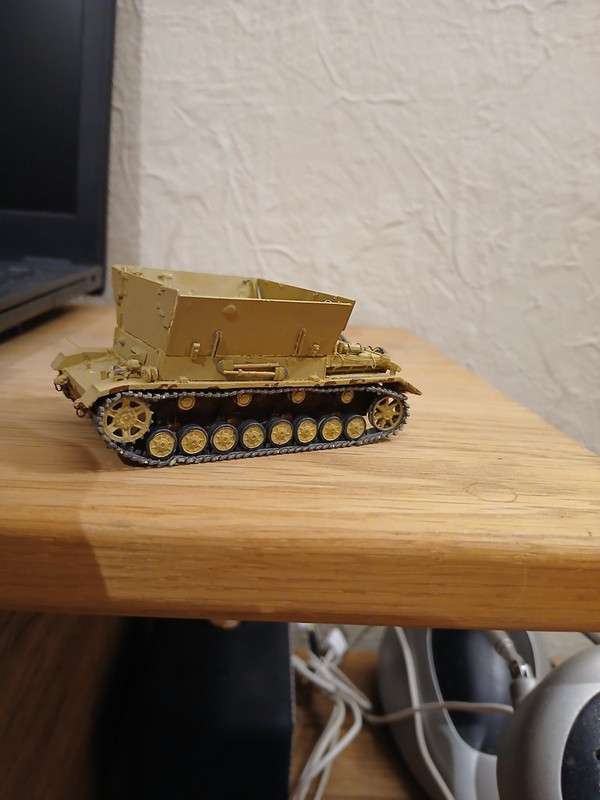

The furniture van is now in the final phase.
The vehicle is painted in dark yellow by Tamiya.
I then sprayed green and red stripes freehand with the airbrush.
The track is from Revell, and difficult to handle. As I already had to glue the superstructure on, Revell added another one on top. There are ejector marks in the area of the support rollers which reduce the gap for placing the track. I was thrilled. I then ground off the ejector marks with my smallest dental cutter (head 0.5 mm). After that, the chain fitted perfectly.
Many kit parts got new places, many had to be made. There were 13 positions on the chassis and 5 on the flak that had to be changed.
The rivets on the struts / supports / hinges were missing on the protective shield. They can only be seen from the outside. I marked the rivets there, pierced them and drilled a small hole. I glued asmall ball from a water filter into this hole and covered it again with glue.
Despite everything, it was fun. So here are the last photos from the construction phases.
The next report will be the gallery post.
Best wishes Jürgen
