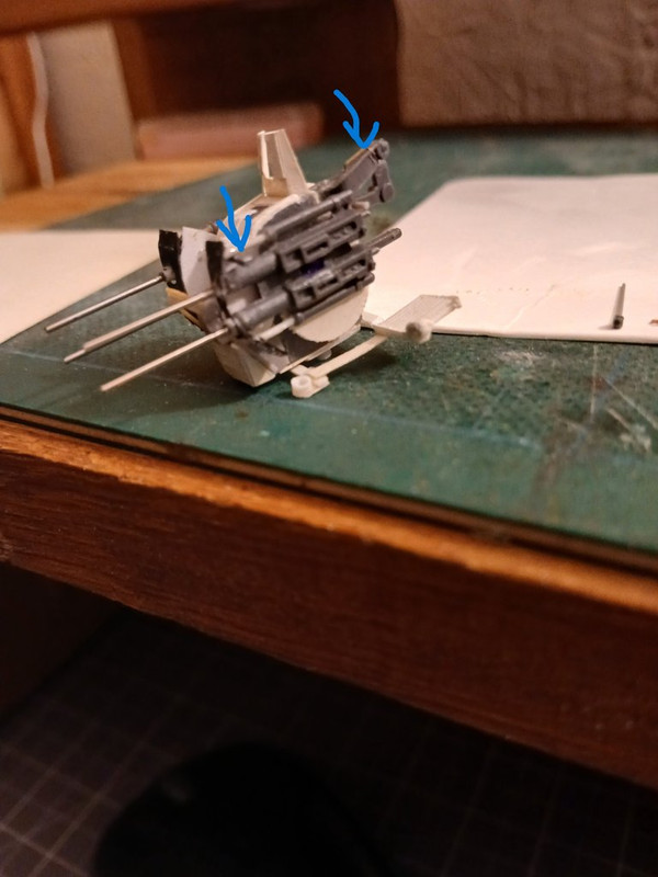

The first thing I did was to drill the inside of the guns to connect the two parts synchronously. Then I added the case catcher. Everything will be made from leftover plastic or Evergreen
profiles. Then there is the forend and another part whose purpose I have not yet found.
Here is the first attempt to use the tubes from Esci. Completely useless, because it is at least
a 7.5cm quadruplet. So I looked for a replacement and came across 0.9 mm syringe needles. After fitting the new tubes, however, they still seemed too thick.
3rd attempt with 0.7mm needles, I like that very much. The muzzle brakes are made from
1.2mm Evergreen profile turned with a Dremel.

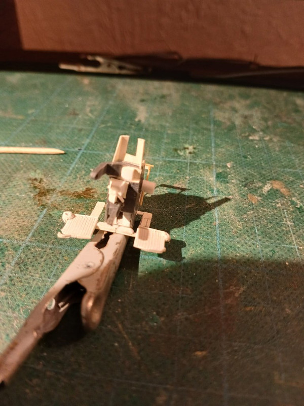

Here I have built the height and side straightener. The corresponding handwheels will be added.

The fairing for the middle weapon box is clearly visible. Foot boards and the hopefully movable visor. I have to install the weapons now because the control rod for the sight is attached to the left side. I have also built 3 new seats for the controls.
I'll glue them on later so they don't keep breaking off when handling the flak.

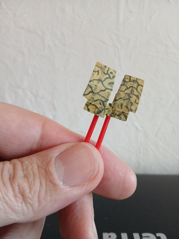

After I cut out the carriage from the 2mm plate, I used a circle cutter. There were also a few failed attempts. Partly I used the Dremel as a lathe. The screws are balls from a water filter that were glued into pre-drilled holes. The round pieces for the ground spikes are also turned with the power tool. I use a tool from Proxon. The transformer and the tool are adjustable. This allows me to regulate to almost 0 rpm. To make it clear, I have primed the carriage and highlighted the parts in color.
Here is a picture of a mishap. The magazine rack got caught on my sleeve, fell down and I stepped on it very skillfully.
Now it's time for the protective shield. First I built the holder that goes into the wooden boards that go in the magazines. I cut the protective shield out of 0.1 mm plastic card. The rivets were pressed in with a pointed tool.
Now I have installed most of the parts I made, only the shield and the flash hider are missing.
muzzle flash hider. These are only added at the end, otherwise the carpet monster will come and eat them.

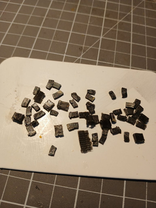

Here is the finished model. Only the magazines are missing. I'm currently casting them in resin,

I had to organise a small casting orgy, I didn't have enough ammunition parts.

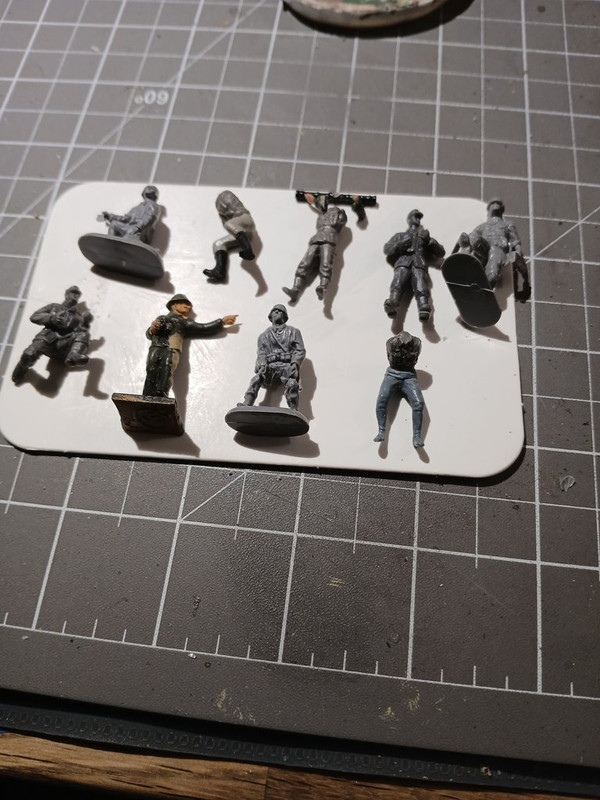

Then I put together the first set of figures.
Does anyone know the companies or sets? Some are easy other figures are rare.

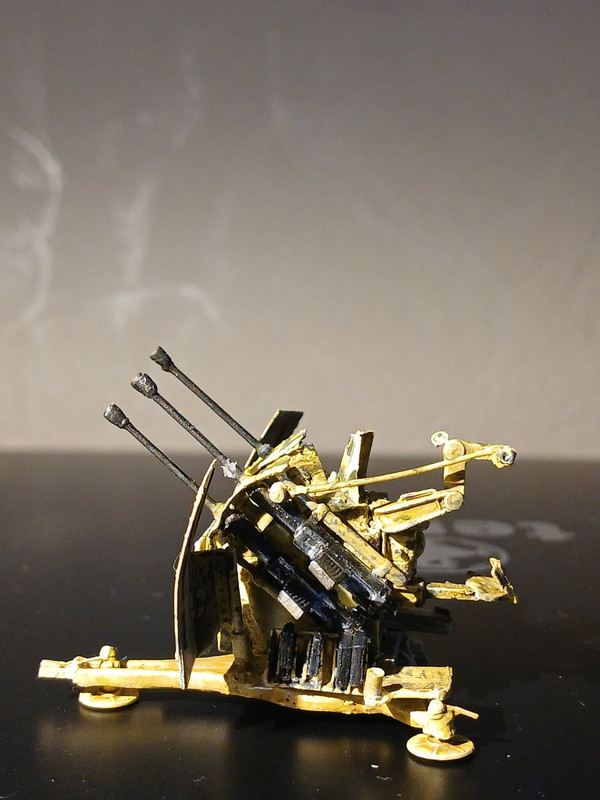

The anti-aircraft gun is painted and I have built it movable as already indicated. This means that the barrel elevation controls the sighting arm with the gunner's sight. The first 2 pictures

As you can see in the last pictures, the flak is finished.
I have collected several figures, some of which I will rebuild, so I thought I would start another little puzzle.
Can anyone identify the figure sets or companies?I had posted everything before, but then came the Temu attack. Everything got lost in the maelstrom.

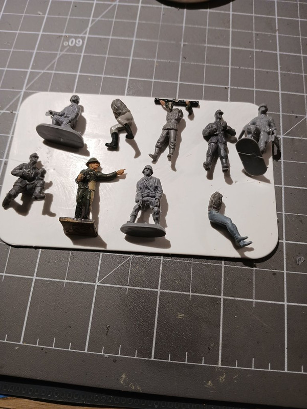

Posted by C M Dodson on 31 Mar 2025, 08:16
Several are the Hat mortar team.
Several looks like the gentlemen from the Esci artillery set.
Great work.

Hi Chris, sorry I'm so late in solving the puzzle with the figures, it's a bit more complex than you thought.I have just become a grandpa for the 2nd time. It was a some what exciting birth . But now everything is ok.

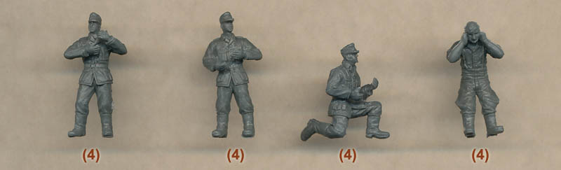

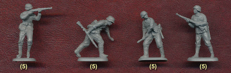

So from left to right .
Had mortars, Preiser, Preiser, Caesar Flak crew, Revell German Pz Grenadiers.
2 row
Caesar Flak crew. OldEsci , Hät Mörser, Preiser.
The Preiser are from the set Dt. Luftwaffe. The set is very versatile, you can make great conversions from it.
In the meantime the figures are also painted.
Here are the pictures.
I wanted to build a figure with the rangefinder. The frame and the knapsack are scratch .
Here are the painted figurs.
Some have already taken their place and work on the base is progressing.

From the Revell set is only the officer I made the NCO. The riding trousers have been sanded down and the high stiffeners shortened and the man with the rangefinder is from Preiser not Esci. Here are the other figures.
url=https://postimages.org/]Image[/url]where to upload pictures
Sorry, I mixed up the sets . Not Caesar Flakcrew but Caesar Howitzer crew.
