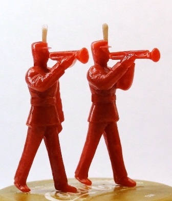

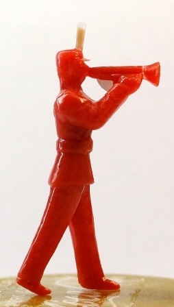

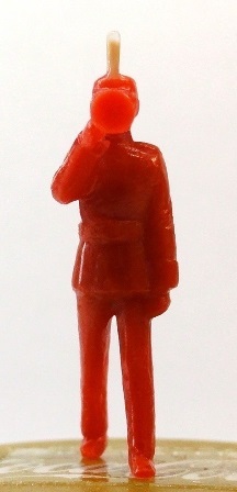

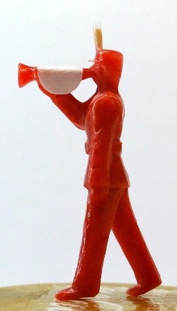

By the way, I can now post the pictures of the band's latest signing, one of the three buglers.
To get it I used the same starting figure from the Airfix set as for the previous trumpeter:
In this case, I have kept only the right hand on the instrument, but to make it look more like a bugle than a trumpet, I have reduced its length by cutting a small piece and have also added a piece of paper reinforced with white glue where the royal coat of arms will be painted. This is the figure obtained:

Best wishes to all of you. :-)

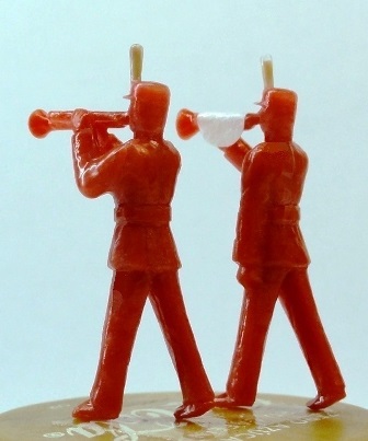

Posted by Santi Pérez on 18 Nov 2024, 19:23
I have taken a couple of pictures of the trumpeter and the bugler together to appreciate the main differences between them, despite having used the same original figure for both. :-D
Here they are:

Posted by Ochoin on 18 Nov 2024, 20:38
Coming along nicely.
I am not a musician - unless you count the bagpipes. I can play two tunes. One is "The Black Bear'. The other isn't. So this comment should be taken for what it's worth.
Both instruments are brass. However, I have seen trumpets that have a 'silver' finish. Would this be appropriate for your figures, to better differentiate them?

Posted by Santi Pérez on 20 Nov 2024, 20:41
Ochoin wrote:...Both instruments are brass. However, I have seen trumpets that have a 'silver' finish. Would this be appropriate for your figures, to better differentiate them?
Thanks for the advice, Donald. I've been looking at different videos and pictures of the band I'm trying to represent and I've seen that most of the brass instruments, although they are all brass, appear mixed in two external colours (gold and silver); however, others seem to be always the same colour, such as the saxophones, gold. :-)
When I proceed to paint the figures I will try to reflect reality and mix instruments in both colours. ;-)

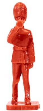

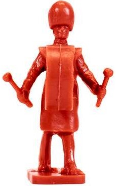

Posted by Santi Pérez on 30 Nov 2024, 19:20

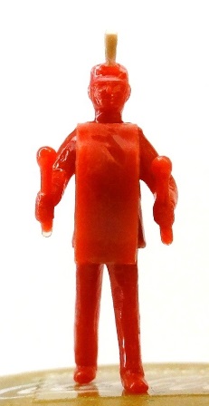

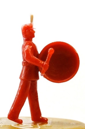

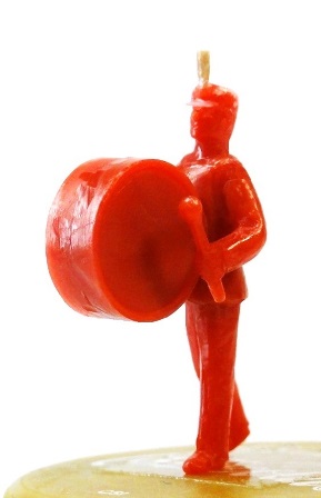

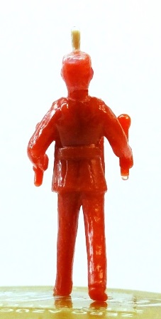

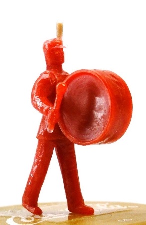

The last finished musician has just joined the band. He's the bass drummer. :-D
I used the original one from the Airfix set as starting figure:
In this case, the basic conversions consisted, apart from turning the fur cap into a ros, of changing the position of the arms to bring them closer to the drum and eliminating the apron present in the original figure. ;-)
And this is the final result:

Posted by sberry on 01 Dec 2024, 11:12
Santi Pérez wrote:In this case, the basic conversions consisted, apart from turning the fur cap into a ros, of changing the position of the arms to bring them closer to the drum and eliminating the apron present in the original figure. ;-)
Image Image Image Image Image Image
Looking at the result, it is impossible to guess that the figure had originally that apron. Must have been quite a difficult task to get such a clean result!

Posted by Santi Pérez on 04 Dec 2024, 20:40
Thank you very much for your kind words, dear colleagues. :-)
sberry wrote:...Looking at the result, it is impossible to guess that the figure had originally that apron. Must have been quite a difficult task to get such a clean result!
You're absolutely right, sberry. Removing elements from the original figures is not always a particularly easy task, because it's difficult to cut cleanly through the kind of plastic they are made of. When you do, you are always left with tiny strips of plastic that are very difficult to remove. That's why I also apply several layers of white glue which, apart from helping me to model the shapes, serves to cover the defects and get the best possible final result. :sweatdrop:
