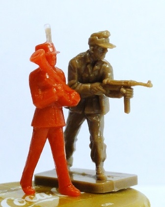

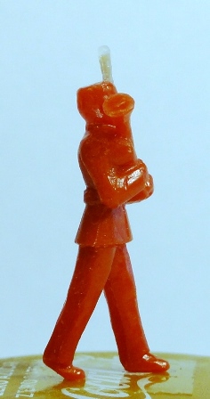

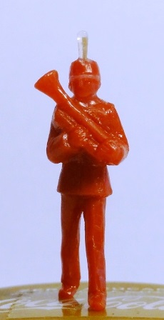

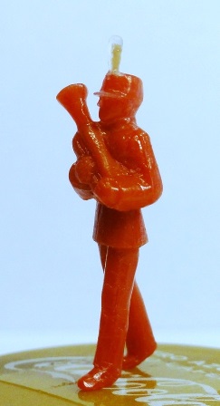

As a test I started with a tuba player:
My first intention was to replace the head of the figure with that of a German Afrika Korps soldier also from Airfix, as his headdress seemed easy to turn into a ros, the typical ‘shako’ of the Spanish uniform.
However, due to the great difference in size between the two figures, once the substitution was made, the result was a very large head:
So I removed the added head and on the initially amputated one I cut and modelled with white wood glue (my usual material for sculpting) the ros with its plume. This was the final result:
Image Image Image Image Image
I'm quite satisfied with the look of the figure and the process to get it, which was not too difficult. Other figures will require more in-depth conversions. I'm already trying to decide which band member will follow this one. :mrgreen:
Thank you for watching. ;-)

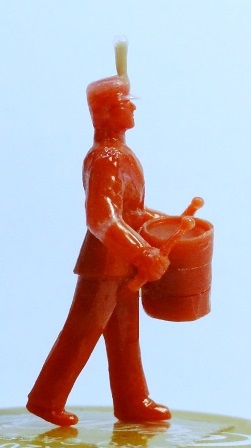

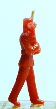

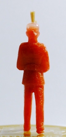

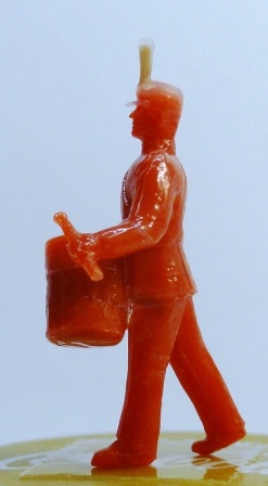

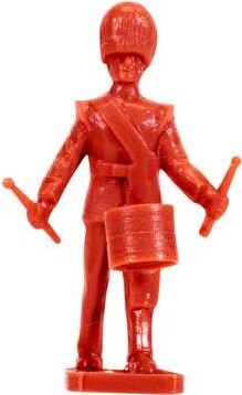

As I announced in the previous post, this is the first of the drummers. And as I also told there, in this case I had to work on three elements of the original figure to get the final result:
- Elaborate the new headgear, something common to all the band components.
- Make the drum a bit longer by adding half of another one.
- Change the position of the arms to make it look like he's really playing the instrument. This was only possible by cutting the arms at the elbows and gluing them in the new position, as this plastic can't be bent and keep the shape.
The original figure:
And the new one:
The next figure is already in progress. In this case it will be one with a totally original instrument not included in the Airfix set. ;-)

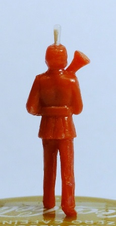

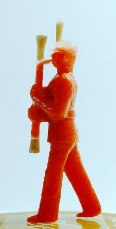

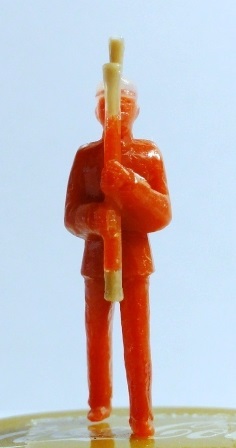

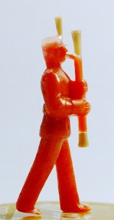

The third member of the band is here. He's a bassoon (fagot in Spanish) player. Since the Airfix set doesn't include this instrument, I decided to make it from the saxophone, so this was the starting figure:
To make the conversion, I cut off the lower end of the saxophone and then added two new ends to lengthen the straight instrument, one at the top and one at the bottom. I got these ends from the machine gun barrels of two figures from the Airfix Afrika Korps set. I kept the curved top end of the original saxophone as the mouthpiece of the resulting bassoon.
This was the bassoon obtained, compared to the original saxophone:
Finally, I sculpted the ros on the head and this is the finished figure:

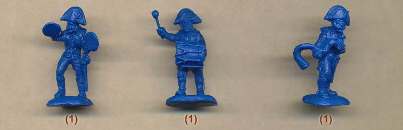

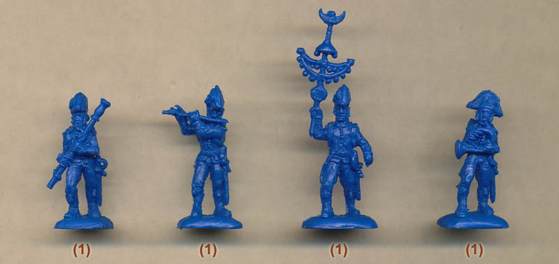

Bessiere wrote:Amazing work Santi. I keep dreaming about a French Imperial Guard band hoping someone will create one but you make me wonder if I could make it myself. I am patient but enough to create an entire band (20pc) ? Not quite that patient...
It's true that for the band you want, Bessiere, it would be necessary to deeply convert the original figures of this set, due to the important differences in the uniforms. But if you have the patience, I invite you to give it a try. I'm convinced that the result would be worth the effort. :-D
Another possible solution would be to use the musicians from Strelets' set 013 (Napoleon's General Staff), complemented with the drums and fifes that almost all Napoleonic infantry sets usually include:
Image Image Image

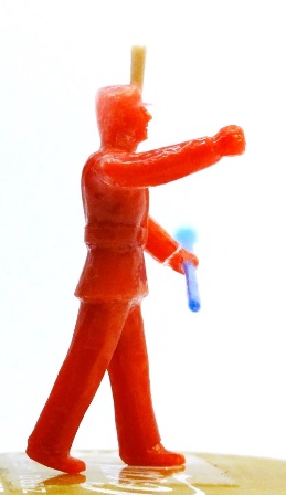

Back to my Spanish Royal Guard band, the drum major figure is costing me more than I thought, as I'm finally not using the figure included in the set as a starting point but a different one. :sweatdrop:
What I have also done at the same time is to replace the tuba player's head with a new one, as the almost absence of the collar and the shape of the ros didn't convince me. Here is the figure with the new head compared to the old one. I think the improvement has been worth it:
As soon as I have the drum major ready and photographed I will post the pictures. :beer:

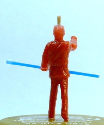

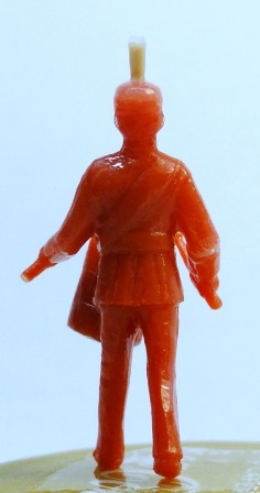

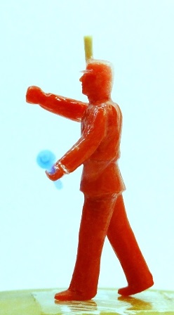

Posted by Santi Pérez on 19 Aug 2024, 20:01
At last the drum major of the band is here. :winky:
To achieve the desired result I didn't use the figure included in the set, but I thought it was more appropriate to use the drummer figure, which required less conversion.
Apart from the conversion of the headgear, I also removed the drum sticks, changed the position of the arms and added a new staff/mace made from two strips obtained from a broom bristle (following the advice of someone in an old thread who used them to make the pikes of the Macedonian pikemen).
And this is the figure obtained:
Mmm, now that I look at the pictures it seems to me that the upper end of the staff/mace is too long in relation to the lower end. I think I'll have to shorten it. :(
Best regards. :-D
